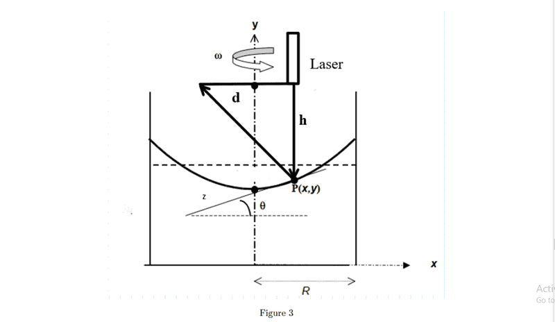

When a bucket full of water is being rotated, the water surface makes a parabolic shape. If we take a cross section of the surface, its slope will be related to gravitational acceleration, g. That means that we can calculate the values of g by taking the slope measurement at various points.
(see figure in the attachments...)
(A) Suppose the bucket has ω angular velocity. Find the slope of the cross-section when the distance from the center of the bucket is x. Consider the horizontal and vertical components of the forces acting on a small packet of water, a distance "x" from the center of the bucket.
The height of the water surface will remain constant when x = R √2 , where R is the radius of the bucket. This is the condition of maintaining a constant column. This provides us with a stable point to measure slope.

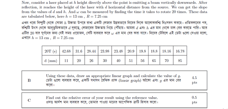

Now, consider a laser placed at h height directly above the point is emitting a beam vertically downwards. After reflection, it reaches the height of the laser with d horizontal distance from the source. We can get the slope from the values of d and h. And ω can be measured by finding the time it takes to rotate 20 times. These data are tabulated below, here h = 13 cm , R = 7.25 cm.
__________________________________________________________________________________________
| 20T (s) | 42.68 | 31.6 | 28.44 | 23.98 | 23.48 | 20.9 | 19.8 | 18.8 | 18.16 | 16.78 |
| d (mm) | 11 | 20 | 26 | 30 | 40 | 51 | 56 | 65 | 70 | 85 |
(B) Using these data, draw an appropriate linear graph and calculate the value of g.
(C) Find out the relative error of your result using the reference value.

I did (A) by balancing force on point p (in the figure). I found slope , tanθ = (w^2)x/g. I dont know what to do next. Pls help

Well, perhaps you want to continue with part B :wink: ? In that case you will need a relationship between slope ##\theta## and distance ##d##.
A little geometry around point ##P## should do the trick !
PS I must say I don't understand "The height of the water surface will remain constant when x = R √2". Can you explain it ?

my bad, it was supposed to be R/sqrt(2). well, that means, even if i change the angular velocity, the height of the water column would remain constant

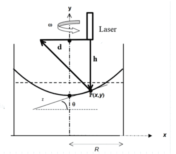

also, after a bit of geometry, i did find the angle adjacent to h (at point P) to be 2 times theta. but i dont know how to proceed from there

So you want to expresss ##d## in terms of ##\theta## and ##h##. How about a tangent?

yeah i realized that. ## \tan 2 \theta = \frac d h ##. And i also know, ## \tan \theta = \frac {\omega^2 R} {g \sqrt{2}} ## . I can relate these two with $$ \tan 2 \theta = \frac {2 \tan \theta} {1 - {\tan^2 \theta}} $$ . But that would give me a complex equation. i need to get a linear equation so that i can plot this in a graph and find its slope and then find the value of g. So i need help . ( ALSO THANK YOU VERY MUCH FOR THE LATEX GUIDE)

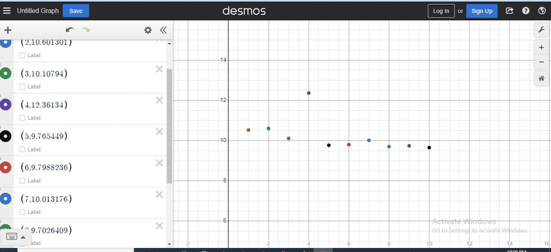

Thanks, I think I'm getting somewhere. here's the graph i got.
Though I'm a bit doubtful about the result of data number 4, g can't be that high. Do i have to draw a best fit line?? everything else seems to be almost in a straight line. Or do i just have to calculate the average?

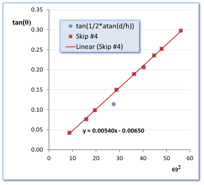

I am a lazy bugger and prefer to let the computer do the work :smile:
So I let it calculate ##\theta = \arctan(d/h)/2 ## and plot ##\tan\theta## as a function of ##\omega^2##:
where I consider point 4 a typo or something definitely wrong.
So I leave that out and then let it plot a trendline. Result ##\tan\theta = 0.0054 \,x -0.0065 ## (confirmed by a regression -- not that lazy, apparently).
Slope of 0.0054 should be ##\displaystyle {R\over g \sqrt 2} ## so that ##g = 9.82## m/s2
Bull's eye !!?! Too good to be true ?

Me too ( a purist, that is; always disliked parity plots ). But I wonder what the righthand side of a plot is. And measured/calculated tend to contaminate frequently despite good intentions.
And I do prefer the figure in #12 over the figure in #10.
... there is the smalll matter that it's accidentally the wrong figure (with intercept 0).
The one intended is:
:smile: with a 4% different ##g## 🤔
(more work needed: discarding a point is a no-no; slope is ##0.00540\pm 0.00005##, intercept ##-0.00650\pm 0.0020## -- yes/no intercept zero, etc, etc)
