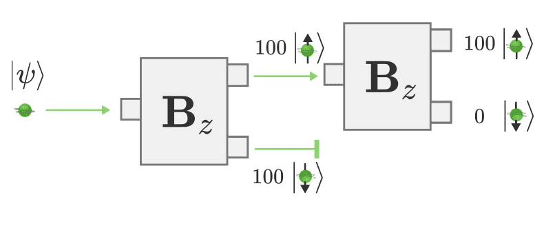

I think I can frame my argument using what I was trying to get across with the principle @DrChinese pointed out to me about steering in that other thread.
Once you separate a photon into one of two states using a polarizer, if you measure that photon in either path using a second polarizer with the same orientation you will only see that photon in the same state as it came out through the first polarizer. This is what is taught in a basic quantum mechanics course.
My point of bringing this up is there is nothing you can do to an entangled photon partner to steer a photon so it is detected in both paths of the second polarizer, but that does not mean the photon can't be steered. Just because a photon can only come out of two paths for a polarizer does not mean the actual photon can only have two polarizations values. The actual photon could have say a polarization value up to +/- 45 degrees from the state it came out of the first polarizer and still go through the second polarizer and only be detected in one path.
In the example Sabine gives, you can apply the above principles, and assume flipping one entangled photon can't do anything to change how its partner is measured when both photons are measured the same way. Both photons will be measured as either the same or opposite based on whether you applied the flip or not. However again using the same principle above, that does not mean there is not steering going on, but you won't see it when you measure the photons the same way.
And why do I think there is steering going on? Because when you measure the two entangled photons at an angles different from each other, you see differences that follow cosine(theta)^2 where theta is the difference between the angles. If there no steering, you would see a straight line graph instead.
This has nothing to do with two entangled photons, which is the subject of Sabine's video.
That's because there is no photon state, period, which gets detected in both arms of any polarizer. Again, it has nothing to do with entanglement.
It does. It says you can't make the photon A go into both paths of the second polarizer no matter what you do to its entangled partner. It says that whatever hidden variable model one uses, it has to have this property. It gives guidance to why Sabine's flip example works as it does in a hidden variable model.
Ok, maybe I said that using wrong terminology, but that does not take away from my point. I thought it was called "state" as what you measure when you detect what path the polarizer it went through. Maybe measurement value is the right term?
It says you can't run any experiment that will detect a single photon in both paths of the second polarizer. It says that whether or not the photon is entangled with another one. The entangled partner is irrelevant. It is of course true that this statement holds for an entangled photon--because it holds for any photon whatever. But it is irrelevant to any discussion of entanglement since it has nothing to do with entanglement.

Here is the picture of Stern Gerlach cascade that illustrates what I was trying to explain. It is just one arm of the entanglement experiment and uses particles with charge as opposed to photons and polarizers, but the same principle applies. Also imagine the 2nd arm with the entangled partner particle where you try to do something on it to steer its partner.
Repeating my argument, but for this picture. Nothing you do to the entangled partner can give you anything other than 100 percent up state in the final Stern-Gerlach Bz. Meaning that any attempted steering when the particle is between the first Stern-Gerlach and the final Stern-Gerlach will not be noticed.
So if we take this as a matter of principle for entangled particles, flipping the spin of the entangled particle can't change the spin of its entangled partner otherwise you would violate this. So if steering is going to happen the steering has to remain in the up state of the z axis. I would think that being in the upstate of the z-axis doesn't mean it has to be a pointer perfectly aligned with the up vector, but could be at some angle from it, but never so much that it is closer to the down vector of the z-axis.
That said, I assume once it goes through a Stern-Gerlach that any vector state is going to be very much aligned with the magnetic field as we only find it in two spots on the detection screen.
So I don't think Sabine's example of flipping disproves instant non-local steering or what she describes as “if you do something to one particle in an entangled pair, then that will immediately affect the other one.”
