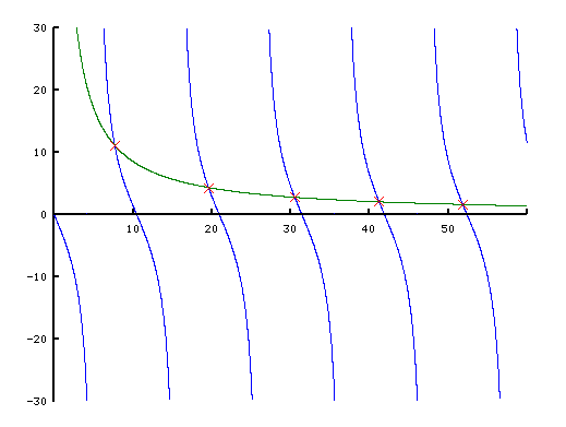

Lets recap:
At ##t=0##, ##x(0)=x_0##, ##v(0)=v_0## ... which you are not given, so this is just notation.
At some time later: ##t=a##, ##x(a)=x_a##, ##v(a)=V_a## ... which you are given. a=0.3 etc right?
If the mass is displaced by a distance A and ten released, then: ##x_0=A## and ##v_0=0##
And you have equations of motion:
(1) ##x(t)=A\cos\omega t## and (2) ##v(t)=-\omega A\sin \omega t##
(2)/(1) gives you:
##v(t)=-\omega x(t)\tan\omega t##
plug in your known values and divide through by the frequency:
$$\frac{v_a}{\omega} = -x_a\tan\omega t$$ (BTW: did you misplace a minus sign?)
This should be where you are up to - I've rearranged things a bit. Let me know if I've lost you.
Note: you cannot get rid of the tan function.
Anyway: this is an equation of the form ##f(\omega)=g(\omega)## ... i.e. the solutions are the values of ##\omega## where ##f(\omega)## intersects ##g(\omega)##.
Use your computer to draw you a graph of ##f## and ##g## vs ##\omega## and where those lines intersect are your solutions.
I'll start you off:
... above: the horizontal axis is frequency, the green line is f and the blue line is g
I've marked the solutions in with a red x.
Notice how the periodicity of the tangent function in g means there are an infinite number of solutions. Your prof seems to intend you to pick the first one ... you should be able to see the frequency is about 7rad/s ... you need more accuracy than that :)
I graphed it and got the answer for omega is 7.7 rad/s. I was wondering if there is a way to do this algebraically as we won't be allowed graphing calculators on our exams. Btw thank you for helping me with this, it makes more sense now.
You could use the Newton-Raphson algorithm (look it up) and your knowledge of the shape of the sine and cosine graphs. Or just a lot of trial and error (guided by a sketch of the graphs.) You only needed 1dp so it is probably doable.
I doubt you'll get that in an exam - unless they also tell you the spring constant or something.
An assignment is more likely.
Note: the other assumption amounted to ##v_0=\omega A## and ##x_0=0## ... which gets you a straight line intersecting a tangent graph.
