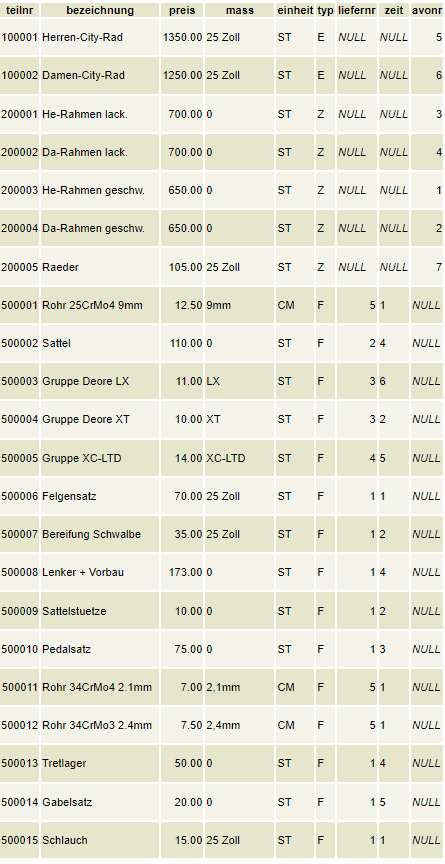

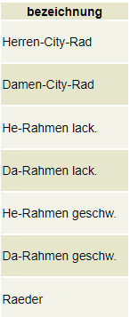

With the code I wrote above I get :
These have NULL as liefernr. I thought to check if they have a liefernr since I don't see how the parts are related with the auftrag table. So is my approach wrong? :unsure:
To see the whole table I wrote :
SELECT *
FROM teilestamm T
and we get :
Doesn't liefer mean supplier? :unsure:
Perhaps the company sells bicycles (Rad)? That would explain why bicyles do not have a supplier.
I think we have a company that buys parts from suppliers.
The employees work to put those parts together to create upper parts.
And those employees sell the parts to customers who place orders to get them.
The table auftragposten identifies which parts are part of an auftrag.
So I believe we are looking for parts that are not referred to in auftragposten. 🤔
