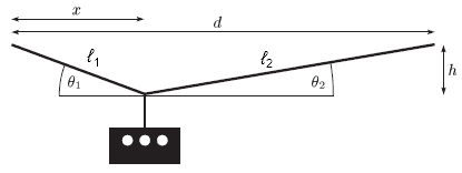

Find approximate expressions for T1 and T2 that are
valid when h/d << 1 and h/x << 1
T_{1} =\dfrac{mg\left(d-x\right)}{dh}\sqrt{1+\dfrac{x^{2}}{h^{2}}}
T_{2} =\dfrac{mgx}{d}\sqrt{1+\dfrac{\left(d-x\right)^{2}}{h^{2}}}
h^{2} =\dfrac{\left(L^{2}-d^{2}+2dx\right)^{2}}{4L^{2}}-x^{2}=\dfrac{\left(L^{2}-d^{2}\right)\left(L^{2}-d^{2}+4x\left(d-x\right)\right)}{4L^{2}}
Not sure where to begin!

There's a spurious h in the denominator in your first equation. I assume it's a typo.
Since you want approximation for small h, rearrange things so that the surds take the form ##\sqrt{1 + \frac{h^2}Z}## for suitable Zs. Then you can use the binomial expansion.

bobred said:
Having a bit of a block with the rearranging, any hints?
##\sqrt{1+\dfrac{x^{2}}{h^{2}}} = \frac 1h \sqrt{x^{2}+h^{2}}##. Can you do the next step?
Likes bobred
I get that, thanks, and I get
T_{1} =\frac{mg\left(d-x\right)}{h}\sqrt{\frac{x^2}{d^2}+\frac{h^2}{d^2}}
That's not the form you want. You don't want ##x/d## inside the radical. You want a 1 in there. You have
$$\frac 1h \sqrt{x^2+h^2}.$$ Factor something out of the radical so that one of the terms is 1 and the other is <<1.

I need to show that the cable can withstand a tension of
\frac{mgd}{4h}
I have tried many things but cannot get the expression.

I don't think that's quite what you mean. Let me guess:
The diagram represents a cable car moving across. As it moves, the angles, distances and tensions change. The car hangs from a wheel on the cable which is in rolling contact with the cable, so the tensions in the two parts of the cable need not be the same (because there is a static friction force).
You are asked to show that the maximum tension on any part of the cable is \frac{mgd}{4h}.
If so, there is no reason to be adding the two tensions. You only need consider one tension and its maximum value. By symmetry, the other will have the same maximum value.
Please post your expression for T1 after making the approximation discussed. How will you find its maximum?

Hi, after posting last night I was laying in bed thinking along those lines.
At the half way point x=d/2, substituting into T_1
T_1=\frac{mg(d/2)(d-d/2)}{dh}\left( 1 + \frac{h^2}{2(d/2)^2} \right)=\frac{mgd}{4h}\left( 1 + \frac{2h^2}{d^2} \right)
so as \frac{h}{d}\ll1 then the expression in brackets is approx 1 so
T_1=T_2=\frac{mgd}{4h}
Therefore the cable must be able to support this tension.

Yes, that's good. However, you've not shown that this is the maximum tension it will be subjected to. It's not clear to me whether you are supposed to show that.
Likes bobred
It doesn't, but showing why would be a good idea.
For T_1 taking the approximation into account
T_1=\frac{mg(d-x)}{dh}
taking the first derivative wrt x and making this equal zero the value for x is d/2 so half way along the cable where T_1=T_2

Good. But does that show it is a maximum there?
No, differentiating again gives a negative result, showing a maximum.
