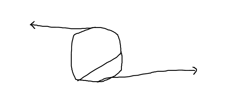

Does torque and a linear force not have the same effect?
Depends what you mean by applying a torque. To exert a pure torque, i.e. no net linear force, the natural way is to exert two equal and opposite forces and on different lines of action.
This will not be exactly the same as applying any single linear force.
What exactly is the difference? With the single linear force there is compression of the circle and with torque it just rotates about the spot?
You only show the two forces exerting the torque. Yes, it will rotate, accelerating, on the spot... assuming they are equally spaced from the mass centre.
If you take one away the rotational acceleration will halve, but there will also be a linear acceleration.
Did you intend other forces present?
gravity and normal force. was wondering how torque and linear force differs, that's why I provided my explanation.

If you apply a pure torque to a wheel standing on a frictional surface then, up to the static friction limit, you may achieve just the same as with a single force. So in some circumstances it is equivalent in effect, but not in others.
