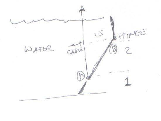

1. Homework Statement
The tension in the cable is 800LBs. Find the depth of water that produces this tension. The gate is hinged at B; the cable is attached at A. (Figure 1)
OK, so this is just 2 opposing lever arms: the tension in the cable is pulling the gate closed (clockwise) and the pressure of the water is trying to open the gate (counter-clockwise).
So we start on the easy side.

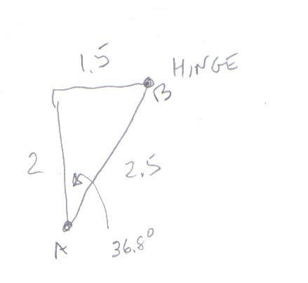

Given the geometry, we know that the gate forms a 3/4/5 triangle and therefore the angle between the gate and the vertical is 36.8 degrees (Figure 5).

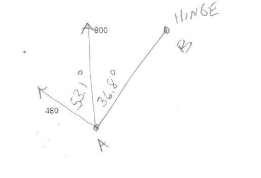

An 800-LB pull on the cable translates into a 480-LB pull perpendicular to the gate (Figure 2).
The cable's lever arm is therefore (480)(2.5)=1200 Ft-LBs.

Hand-drawn sketch of a hinged gate in water: a wavy water surface at top, a cable from point A running up to the surface, and the gate hinged at B on the right, sloping down to the bottom. Labels include WATER, CABLE, HINGE, and depth marks 1, 1.5 and 2.

Hand-drawn statics diagram of a triangular gate hinged at B, with segment lengths 1.5 along the top, 2 on the left side and 2.5 on the slanted side from A to B, and a 36.8° angle marked at A.
Handwritten sketch of a hinged gate: a diagonal line from hinge B down to point A, with a 36.8 degree angle marked against the vertical, a cable from A up to a point labelled 800, and a 480 force component along a line to the left.

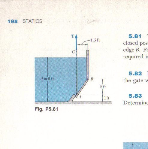

The depth of the water, which they are consistently calling h in the book, is supposed to be 5.18 feet to create the 800-LB tension in the cable.
For some reason, I am unable to upload another diagram, so I parked the diagram here:
http://www.firstbyteashville.com/images/problem580fig6.jpg
In this diagram, which applies to a similar problem, they show a 6-foot-deep pool of water.
In other similar problems in the book, when they do not specify otherwise, we assume the gate is 1 foot wide. So I have made that assumption here. Thank you again in advance.
