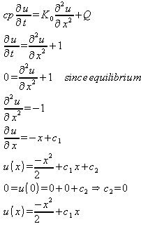

First I did the calculations for the first part of the rod (0<x<1)
Handwritten derivation of a steady-state heat equation solution: cp du/dt = K0 d2u/dx2 + Q, then equilibrium gives u(x) = -x^2/2 + c1 x + c2, with c2 = 0 from u(0) = 0.

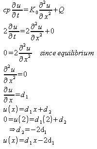

Then I did the calculations for the second part of the rod (1<x<2)
Handwritten derivation of a steady-state heat equation solution: cp du/dt = K0 d2u/dx2 + Q, then 2 du/dt = 2 d2u/dx2 + 0, 0 = 2 d2u/dx2 since equilibrium, d2u/dx2 = 0, du/dx = d1, u(x) = d1x + d2, 0 = u(2) = 2d1 + d2, d2 = -2d1, u(x) = d1x - 2d1.
