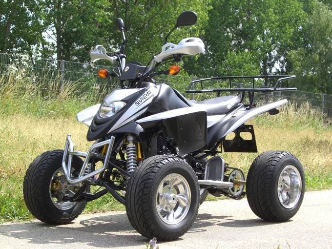

To put this into practical context: if i drill and place a 6mm bolt in one wishbone arm on the quad bike, do i fatally weaken the 32mm dia arm ?

im just pondering ways to clamp the A frame to the wishbones, and the relative merits of several ways i can think of doing it.
One way i thought of requires a 15mm radius U bolt made of 6mm steel being inserted into the front leg of the wishbone on each side (theres 4 legs each side remember), this then allows me to create a horizontal U shape which i can close round the leg U bolt with a pin, and that would provide enough free play to take any bouncing or spreading of the wishbone on bumpy ground.
The alternative would be simply to close the A frame U around the wishbone arm, but that requires a larger assembly,
So are you trying to create an a-frame so you can tow the quad behind a car like a conventional trailer? I can't see this as a very safe or efficient or legal way of transporting a quad. With all four wheels on the ground, the quad would not tow very well.
If the quad is to be towed only short distance, maybe consider something without an a-frame as it will not have to take much weight. without knowing details of your quad this is hard to to.
A suggestion could be bolting some type of frame where there are already bolts on the quad?

I do not yet understand the details of the joint you are asking about. Would you be able to post a sketch of your proposed assembly? And could you post a dimensioned sketch of the joint details?
Also, what is the mass of your quad bike? Is the picture in post 8 your exact quad bike? If so, does it have a mass of 160 kg?
its virtually the same design as the VW A frame thumbnail i posted. The detail we are discussing is how to attach the frame to the bike. I wondered if i could insert U bolts into the lower front wishbone arm, so there was two towing lugs, in the same way a car has a towing lug on the front, hence the question, would inserting a 6mm U bolt (2 holes 50mm apart on each side) into a 30mm tube fatally weaken it.
The other way i thought of would be to use exhaust U bolts large enough to go all the way round the front lower tube of the wishbone arms. This would be less elegant but prolly safer, and not as quick to attach/remove.
That is the exact quad bike, according to the book its 292 Kg
jakedehaas said:
Placing a bolt through the hole will not remove the stress concentration caused by the drilled hole.
I agree. The bolt does not restore the tube strength, in any way. This answers one of your primary questions.
If I had to guess, without a detailed drawing, I would currently say there is perhaps a 10 % chance your proposed connection could fatally weaken the wishbone round tube, whether you drill through the tube, or clamp around the tube without drilling.

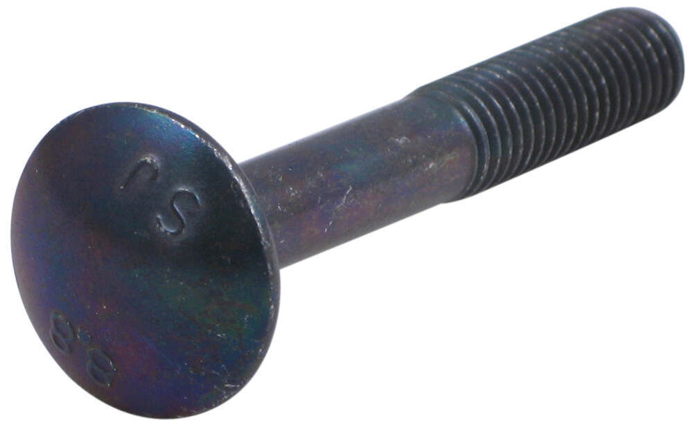

Heres the Mark I version, i used clamps in the end, held by M8 bolts, with wing nuts spun on and then trapped in place so they can't shake off by hitch pins. Foolproof...the holes through the tube where the M8 bolts go are lined with 10mm x 1mm steel tube to prevent the square frame sectionfrom collapsing under load.
http://i55.tinypic.com/avh0rd.jpg
http://i55.tinypic.com/hti45t.jpg
Edit by Borek: too wide image replaced by link
(1) It appears you used carriage bolts. Carriage bolts are generally for wood or low-tension applications. They do not necessarily have a strong head, and often are not designed for high-tension steel joints. The head might be able to pop off. Use a regular, hexagonal-head M8 bolt in which you ensure the head is marked "8.8," which means ISO property class 8.8 steel. If you use a carriage bolt, ensure its head is marked "8.8."
(2) Wing nuts are generally low-grade steel, and unmarked, if I recall correctly. If your wing nuts are not marked ISO property class 8, then change to regular hexagonal nuts marked ISO property class 8, which means they must have dots exactly in the positions shown here.
(3) Usually use a flat washer under the bolt head and nut.
(4) For locking, you could perhaps use or add a http://upload.wikimedia.org/wikipedia/en/4/42/Castellated_Nut_%28new%29.png , hexagonal, ISO property class 8 nut, and a split (cotter) pin.
(5) Ensure little or no twisting force is applied to the joint when you fully compress or extend the wheel suspension.
(6) My estimate for fatal damage to the wishbone tube is in post 12. Maybe I should increase the percentage slightly, but I do not know the exact tube wall thickness. I guess I will leave the estimate as-is, for now.
(7) The rear weld on the towing A-frame might be overstressed, although I do not know. I am just mentioning this as a possibility, because no one quantified the loading conditions on that weld.
(8) The safety chain or cable, and attachments, must be able to withstand the rated load capacity of the towing A-frame. In the event of failure, the safety chain or cable must prevent the towing A-frame from dropping to the ground.
