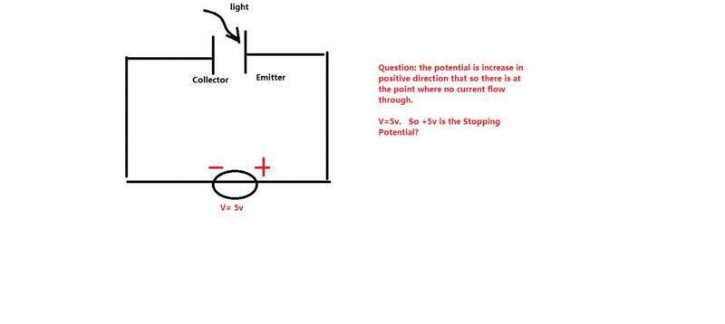

[URGENT! Stopping Potential~~~~~~~#######~~~~~~~~~~~~~~~~
max Kinetic_energy= e*Vs=hf-work_function
Vs is the stopping potential
The attempt at a solution
I am wondering, does this stopping potential refers the voltage difference of
V_Emitter (where the line shines on) - V_collector(where the electron travels to), and thus, the stopping potential is usually positive?
Also, for that equation max kinetic_energy= e*Vs, 'e' is just the charge= +ve 1.602*10^-19?
so that the max kinetic energy in this case, (+5 V)*(+ 1.602*10^-19)= +ve number?
  • Circuit schematic of a photoelectric setup: a light arrow hits an emitter plate and a collector plate in a loop, with a voltage source labelled V = 5v marked with minus and plus signs; the handwritten question asks about stopping potential.
If you use e as elementary charge, it has to be positive.
If you use the electron charge, you need the opposite direction, and a negative voltage. That is just a matter of definition.
What do you mean with "+ve number"? If you add units, you will get the right result.
