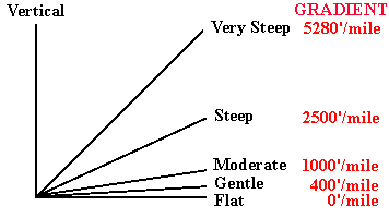

How can we determine which curve has larger slope just by looking at curves.
http://www.meritnation.com/img/shared/userimages/mn_images/image/a_2_12_2.png
Which curve has larger slope?
First, check to see that the axes are scaled the same, then look for which one is steeper.

I just have to tell which curve has larger slope,i.e I don't want to determine absolute or exact slope .I just want to compare slopes of the two curves which I have posted.Is it also not possible?
You can ASSUME both are scaled identically and pick which has the steeper initial slope (closer to vertical) --- but it's very poor form to make that sort of assumption, particularly between two entirely different graphic styles. It's likewise very poor graphic style to omit any suggestions of scale, but that takes ink, and ink costs publishers money.
Curve 2 in my post,right?
That's the one my eye tells me is steeper. I would still hate to wager large sums of money on what either of the plots actually represent numerically.
So steepness is determined by looking at how straight curve is?Or by how much closer the curve is with y axis?
I think the second one is correct.As this image depicts.
Yes. You've taken calculus?

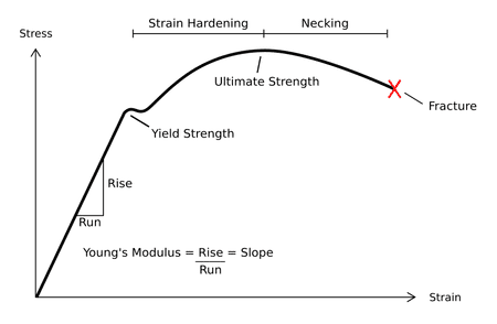

Why stress decreases after point D in the curve below?
mage=http%3A%2F%2Fwww.meritnation.com%2Fimg%2Fshared%2Fuserimages%2Fmn_images%2Fimage%2Fa_2_12_2.png

But I am not getting one thing.Stress=force/area
If there is reduction in cross sectional area stress should increase than why stress decreases after point D (before breaking point)in my curve of post 17.
What's plotted is the total stress. It's not actually divided by the actual cross-sectional area of the "necked-down" section of the test specimen. This link
http://en.wikipedia.org/wiki/Ultimate_tensile_strength may be some help for you. Particularly the section showing the "red" vs. "blue" stress-strain curves, and the explanation that accompanies it describing the two cross-sectional areas used in plotting both of these curves, "A" and "A0."
Bystander said:
This link
Yes.It helped.Particularly this line
"when necking becomes substantial, it causes a reversal of the engineering stress–strain curve as the engineering stress is calculated assuming the original cross-sectional area before necking."
I have interpreted it (the curve of 17 post)in this way.Curve A to B obeys hooks law.Than B to C denotes plastic flow i.e strain increases without increase in stress as in your pizza analogy cheese starts to flow /pull then curve C to D depicts necking as cross sectional area decreases stress increases,lastly curve D to E indicates substantial increase in necking that's why we will consider original cross sectional area so stress will come down to original value|(less than necking region)that's why stress appears to decrease after point D in curve.
Correct?
You have got it.
