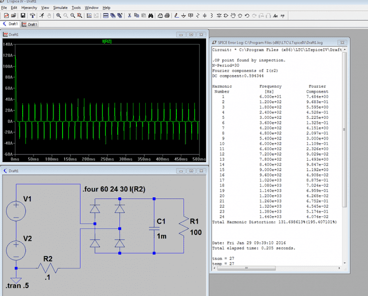

You'll of course look at the current waveform with a spectrum analyzer? - you can't distort line voltage very much so you'll have to FFT current... it's loads of fun.. Get a cheap microphone and 'listen' to household appliances, too . Harmonics... on the cheap...

Anorlunda's simple diode-load should be rich in even numbered harmonics. Symmetric rectification should be odd-rich and even-poor.
Can generate over 100% current harmonics with the rectifier and load above - forgot to say (realize) it needs a capacitor in the load:

That's interesting, windadct
if you let it run does the DC component disappear after a while ?
I'd expect that after say a hundred(?) of those thirty cycle intervals the even harmonics and DC component would almost disappear ?
Is that easy to do with your (impressive) program ?
old jim
Huhh - it is an over simplified - "simulation" - Ideal source and "ideal" circuit / load - but still simpler to say thsn what to expect with a dimmer... yes -- evens would dissipate-esp in the 1 ph case.. - my point being a rectified load creates a crazy non-linear load.
Sorry I do not know if you are being dismissive - it is LT Spice - crazy free and powerful.

Haha - not fluent - I am trying to become so because I know how good it is. When I went to school spice was a text only simulation and for me, impossible - in this case I wanted to use a simple case to calculate THD which I had not done before ( and it was stupid easy- like almost everything else in EE - the complex can be broken down into simple concepts) -- for a free program it is, IMO, the #1 best tool for EE.
I would recommend everyone give it a try - basic ideal sources, R- L - C circuits, filters - etc...the LT SPice exists so that Linear Technologies can sell product, but there is no ads, or other marketing going on, other than the libraries and examples using LT product.
