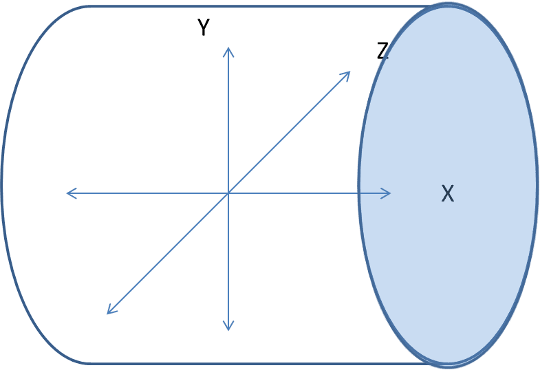

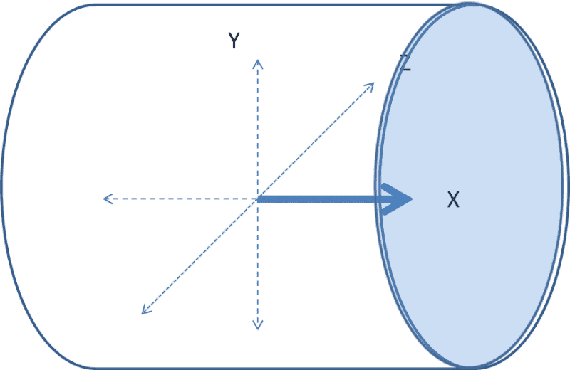

How can the force applied in the X direction against the blue plate surface be equal between these scenarios representing Stagnation Pressure and Static Pressure?
1. A flow (due to a constriction) has converted some energy from Static pressure (diminishment represented by Y,Z,-X,-Y,-Z dotted lines) to Dynamic Pressure ( increase represented by thickened solid X line ).This flow is then instaneously halted by the blue plate surface. (Stagnation Pressure)
Diagram of a cylinder with a blue disc at its right end, showing dashed arrows for the Y axis and six radial directions and a thick solid arrow labelled X pointing right toward the disc.
2. Momentarily later, as the flow is stopped, that same energy constant is applied (according to Pascals) equally in all degrees of freedom within that volume ( represented by equal X,Y,Z,-X,-Y,-Z lines) (Static Pressure)
Diagram of a cylinder with a shaded disc at its right end, with a three-axis cross at its centre labelled X to the right, Y upward and Z diagonally up and to the right.
I cannot see how these equal ?
