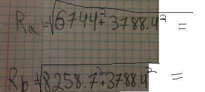

On support B you have the horizontal force Fh and this vertical force Fv.
So what's the total force?
Don't you need to add those vectorially? (or did I miss something as I skimmed down through the solution?)

(You're not supposed to simply add up forces that are perpendicular to each other. ;)
Ohhhhhhh Ok gotcha, now it makes perfect sense :)
I need to find the resultant vector for each! *smacks forehead*
So
(CALCULATION ATTACHED)
Rb = 9086 lb
Ra = 7735 lb
BADABING BADABOOM I said! :)
