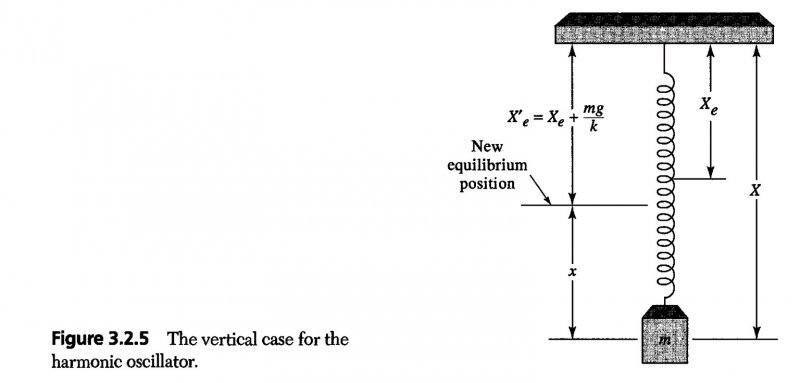

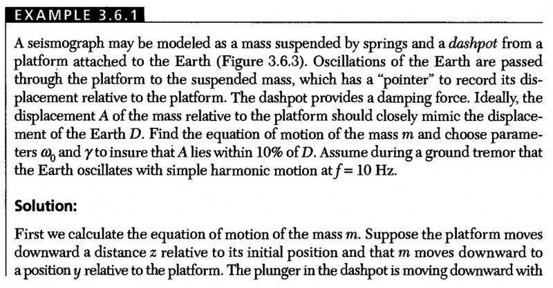

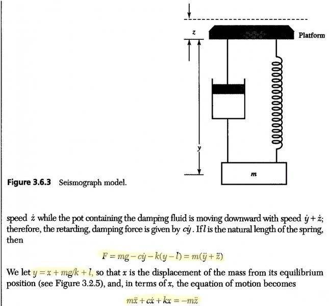

Below is an example problem from my textbook. I don't fathom the highlighted portion where they replace the y variable with x in accordance with fig. 3.6.3?
Please help
Thanks
Doesn't figure 3.2.5 explain it?

Here is the other Figure. Unfortunately, I still don't fathom??
In figure 3.2.5 they are simply substituting in X'e to simplify the equation. From Newton's 2nd law of motion:
∑F = m⋅d2X/dt2
m⋅d2X/dt2 = mg - k(X - Xe) ...(Eq. 1)
At equilibrium we know that ∑F = 0, therefore:
mg - k(X - Xe) = 0
→ X - Xe = mg / k ...(Eq. 2)
Making the following two substitutions into (Eq. 1):
Xe = X'e - mg/k
X = X'e + x
→ m⋅d2(X'e + x)/dt2 = mg - k((X'e + x) - (X'e - mg/k))
→ m⋅d2(x)/dt2 = mg - kx + mg
→ m⋅d2x/dt2 = kx ...(Eq. 3)
Now Eq.3 is simpler than Eq. 1, agreed?
I assume your textbook already has all this.
