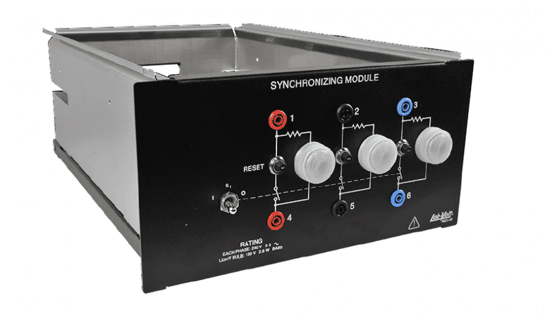

Hi I am Ken. Nice to meet you. I would like to get some info on this synchronizing module. It has a 3 phase lamp for synchronizing an alternator. Any knows what's the theory behind that flashing lamp? what if the lamp blink very fast or blinking slow? the reason is frequency is out of phase but i want to know in details what cause it to blink? Thanks.

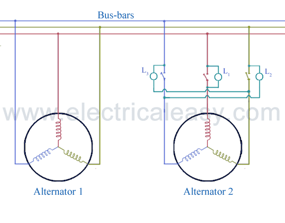

Simplest form is simply a light between the two machines.
you can use three lamps, one per phase if you wish but one will do the job
It should be obvious that when the machines are in phase there's no voltage across the lamps and they all 3 go out,
so it's safe to close the switch when the lamps are out
whenever the machines are not in phase there will be voltage across the lamps
e.g.
at any instant the voltage across a lamp will be the difference (vertical distance) between red and blue voltages
and as phase shifts between 0 and 360 degrees, that voltage difference will grow from zero to twice peak than back to zero
so your synch module must either :
use lamps rated for twice voltage,
or do what we did in the power plant - two lamps in series.
Used to be in Great Britain they preferred to wire their lamps through transformers and swap phase so that the proper time to close the switch was maximum brightness instead of minimum. Sophie might know if that's still the practice.
The lamps also tell you if there's a voltage mismatch - the they'll never quite go out.

Is this it ?
Looks like just lights...

Is this it ?
yes this the one I am using. Because I am analyzing on an alternator synchronization. module needed is the synchronous motor/generator and DC motor/generator. So now I just to get the theory behind that flashing 3-phase lamps.
e.g.
d.wikimedia.org%2Fwikipedia%2Fcommons%2Fthumb%2F5%2F55%2FPhase_shift.svg%2F220px-Phase_shift.svg.png
The lamps are connected between the two generators, that is between the ed and blue sinewaves
one lamp(or pair of lamps) for each of three phases
when the voltage is high the lamps are bright indicating the two sine waves are not aligned vertically, ie in phase
when the sine wavs come into phase , ie vertically aligned, the voltage across the lamps becomes zero so the lamps extinguish
that's the time to close your breaker because zero volts means not much current will flow.
Closing the breaker when voltages are out of phase causes high current and largetorques, it's a violent manuever.
