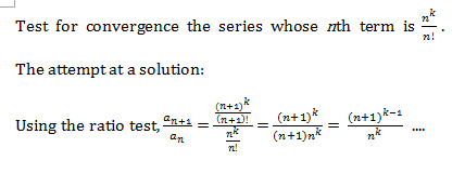

Test for convergence of a series
Michael_Light
112
I have no ideas how to continue. I also tried the comparison test but I don't know where to start. Please guide me...
You want the limit of the ratio as n->infinity. Look at just the \frac{(n+1)^k}{n^k} part. That's the same as (\frac{n+1}{n})^k=(1+\frac{1}{n})^k. What is that limit?
