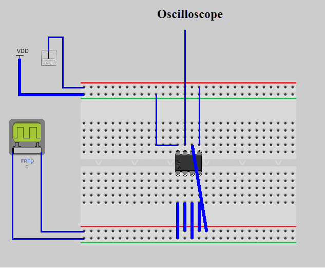

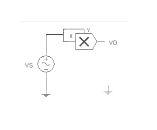

Here is my circuit
I'm trying to double the frequency of my input to my output.
k = 1/10 V
For example: input is VmSin(2\pi1000t)/10
Vo = (VmSin(2\pi1000t))^2/10
Output should be Vm^2/20 + Vm^2cos(2\pi2000t)/20
My oscilloscope isn't picking up on the doubling, so I know my circuit is incorrect. May I have assistance? The ultimate goal, is to develop a phase detector.
Circuit I'm trying to create:
Have you any biasing to define the DC conditions at the inputs?
And ... what is the chip ??
giving ALL the info helps people help you :)
Dave
Apologies! I'm using an AD633 with Vs = +15V and -VS = -15V.. X2 = Y2 = Z = 0

Your picture does not show +/- 15V rails. It shows a positive rail and ground for powering the IC.
And when you correct that, is your signal generator ground the same as the power supply ground? What amplitude and frequency are your sig gen set for?
And when you say "My oscilloscope isn't picking up on the doubling", what does the output look like?

That's what I wanted to make sure of! In order to meet the +/- 15V rail requirement, I'd need a +15V rail and a - 15V rail, yes? So 2 different sources and a separate rail for ground, but I did this and my frequency is not doubled. I had used a red lead for both Vs inputs (+/-) and grounded the negative leads on another rail.
My amplitude(Vm) is 10V and my frequency is 1000Hz.

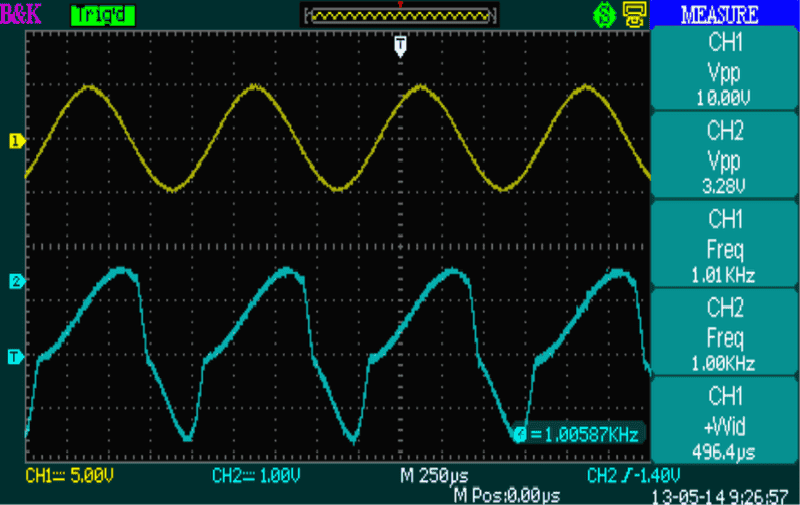

Here is my waveform:
@r19ecua
Is there a problem for you to give us a proper schematic diagram of the exact circuit you are (or think you are) using? Either the chip is broken or you have connected it wrongly and a schematic could help people find what's wrong. It's not too much to ask, is it? You should already have drawn yourself one, in any case.
My first post is the circuitry I was rolling with, the schematic followed soon after.. The VDD is suppose to be the Vs 15V and the ground rail is coming from the negative terminal of the power supply. The problem? I just want to see the frequency doubled using a multiplier (AD633) with X2, Y2 and Z = 0 (grounded). The input frequency is Vm = 10Sin(2pi1000t)V
@berkeman
No, the ground for my function generator is not the same as the power supply ground. Should I make them the same? I was using some virtual breadboard software and it turns out it was a bust.

The waveform I posted is an actual test. I only drew up the circuit via simulation software just so you all could see what I put together. If I were to simulate the schematic on multisim, the frequency doubles. When I put it into practice (by building it the way I initially posted), my results are the waveform I posted. The 2 Vs inputs of the AD633 are receiving +15V (the + & - inputs of the IC).
You have 15 V from +Vs to -Vs. The AD633 datasheet lists a minimum of ±8 V, i.e. you should have 16 V from +Vs to -Vs at minimum. It might work at 15 V but you'll have no guarantee that it'll be within the specifications listed in the datasheet.
For 20 V from +Vs to -Vs, your inputs should be between 4 V and 16 V relative to -Vs (have a look at figure 6 in the datasheet).

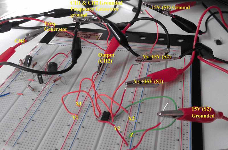

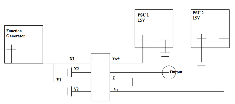

OK, this is my actual circuit:
I have 2 different sources putting out 15V. If you refer to the datasheet there are two inputs.. a VS+ and a VS-. In the picture, I have for both inputs, a +15V going through them. The negative terminal of these two inputs are placed on the same rail and are grounded. X2 = Y2 = Z = 0, these inputs were grounded as well.
My initial guess was to put a +15V(1st source) through the +Vs input(pin 8) on the IC and a -15V (from the second source) on the -Vs input(pin 5) of the IC. The -15V (from 1st source) would be ground and the +15V(from second source) would be grounded as well. X2 = Y2 = Z = 0, these inputs were grounded as well.
Edit: If you refer to the datasheet above, w is my output.
I won't have a chance to look it through until later, but could you try disconnecting the +15 V and -15 V clips and measure the voltage between them with a multimeter?

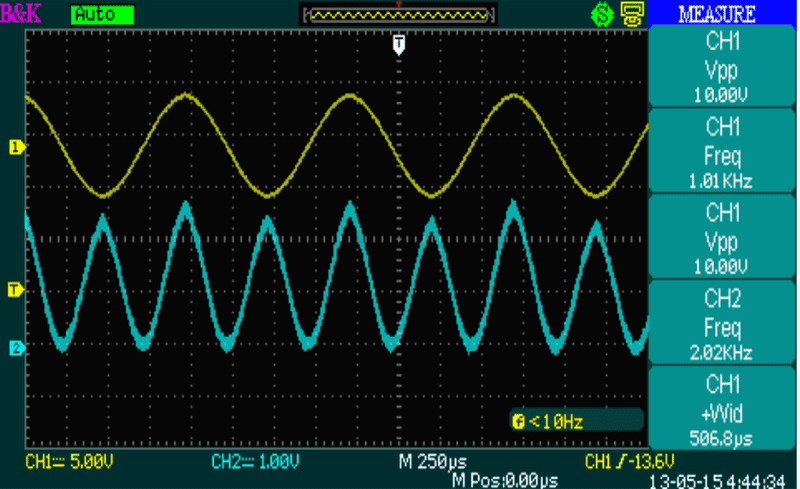

OK, I finally have the frequency being doubled. I didn't draw it, but the clip for my function generator is grounded... This is the circuit I constructed:
my output waveform:
The frequency for my output (CH2) continues to fluctuate between 1 ~ 2kHz. The result is also smaller than expected. Input voltage is 10V as seen by the 5 volts / div. While the output voltage is at 1 volt/div and barely passes 3V. Output was expected to be 5V based on the formula
Vo(t) = Vs(t)^2/10
Vs(t) = 10sin(2pi1000t)
Vo(t) = 5 - 5cos(2pi1000t)V (estimated)
@milesyoung
DMM measures 30V
Your input signal is:
Vin = A*sin(ω*t), A = 5 V, ω = 2*pi*1000 rad/s
Your output signal should be:
Vout = Vin2/(10 V) = (A*sin(ω*t))2/(10 V) = A2/(10 V)*sin2(ω*t) = A2/(10 V)*( (1 - cos(2*ω*t))/2 ) =
A2/(20 V)*(1 - cos(2*ω*t))
The DC offset and amplitude of the AC component at the output should be (5 V)2/(20 V) = 1.25 V, which seems about right for the output you've measured.
I can only recommend that you:
- Bond together the ground of the signal generator and both supplies at a common point so you won't have the noise between them added to the AD633 input signal.
- Move the probe and ground clip as close as possible to the pins for measurements.
- Consider adding some decoupling caps to the AD633 supply pins (as close as possible) as shown in the datasheet.
