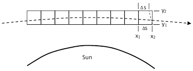

But the total amount of bending after passing a large region is a cumulative effect. It's not local measurement.
J O Linton said:
... and the bending of light in any region of space near a gravitating mass is solely determined by the nature of space-time in the locality.
The bending relative to the local patch of space time is one thing. But the way how those spacetime patches are combined to form a larger region also affects the total amount of total bending, after passing that region.

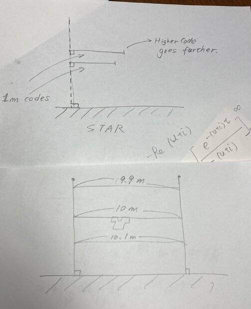

  • #40
J O Linton said:
Since there is no reason to suppose the length of the ruler to change (since it remains at all times at right angles to the assumed uniform gravitational field)
Prepare two 1m codes and make them straight horizontally from the poll. Higher code goes farther than the lower one.

  • #41
PS if the light beam is fired horizontally then there is no issue. The experiment at the top and bottom of a deep shaft will give the same result of ##c##, independent of the gravitational potential.
