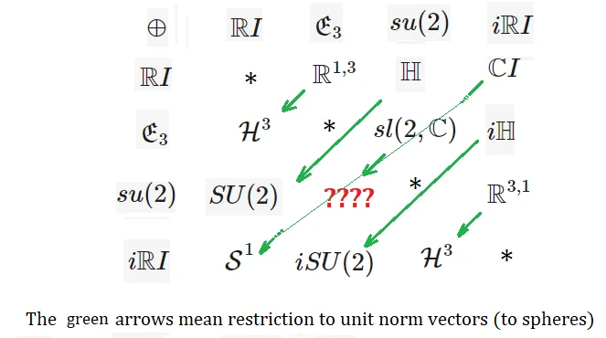

One more question. This is the structure of the set of 2 by 2 complex matrices:
Here, the only non-standard symbol is ##\mathfrak E_3=isu(2)##. It is the 3-dimensional real Euclidean space of traceless, Hermitian matrices, with the half-anticommutator as dot product. What should I write instead of the red "????"— that is, what is the meaning of the elements of ##sl(2,\mathbb C)## whose determinant is 1?
Are you asking about the name and notation for that set? Why do you need a name and notation?
If I read the table correctly, and I'm not sure it even makes sense, then ##su(2)\oplus \mathfrak{E}_3=su(2)\oplus isu(2)=su(2)\oplus su(2).##
All the other objects in the picture have their own names, designations, and significance somewhere. I wonder if this one does too, or is it an exception?
What do you mean by a direct sum of (an additive) vector space with (a multiplicative) group?
I think, elements of ##su(2)## are the traceless anti-Hermitian matrices while elements of ##isu(2)## are traceless, Hermitian ones, so ##su(2)\oplus \mathfrak{E}_3=su(2)\oplus isu(2)## consists of all traceless matrices.
The direct sum of vector spaces makes sense, but that wasn't my question. Besides that, do you consider ##su(2)## as a real vector space? Otherwise (complex), ##su(2)=isu(2).##
I regard them as elements of the (additive) vector space of 2 by 2 matrices.
But ##SU(2)## isn't closed under addition, nor does it have an additive neutral element!
Oh, yes, I consider them as real vector spaces. So, ##su(2)\neq isu(2).##
Yes, it is a sphere in the vector space ##\mathbb H##. At the ends of the green arrows are spheres in the vector space at the beginning of that arrow.
And what is the direct sum of a sphere and a Euclidean space?
Of course, it isn't a direct sum. Direct sum applies only above the main diagonal. Below it, the objects originate from the green arrow.

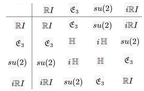

Perhaps this is not important either, but another interesting fact for me is the multiplication table of the members of the decomposition ##M(2,\mathbb C)=\mathbb RI\oplus\mathfrak E_3\oplus su(2)\oplus i\mathbb RI##.
