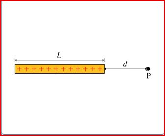

part 2 The Electric Field of a Continuous Distribution of Charge
find the electric potential at point p
v=Kq/r...v=Er.
using this pic above and dQ=(Q/L)(dX)
v=(K)(dQ)/(L-(X_i)+d) then sub dq=dX(Q/L)
we get...
(KQ/(L))(dX/(L+d-(X_i)) then integrating
V=(KQ/L)((-ln(d))+(ln(L+d)))
is this correct? if not could some one tell me where i went wrong.
thanks in advance.
That looks about right except that I would combine the logarithm arguments and write it as
[tex]V=\frac{kQ}{L}ln \left(1+\frac{L}{d}\right)[/tex]
Then you can see more clearly what happens when d is much larger than L.
i see what you are doing but as d>>L it goes to zero..
but does not tell anything about what's below.
a) an infinitely long wire with total charge Q
b) an infinitely long wire with total charge Qd/L
c) a point charge of magnitude Q
d) an electric dipole with moment QL
Not quite, as [itex]d\to\infty[/itex] [itex]V[/itex] will go to zero. For [itex]d\gg L[/itex] you'll want to use the Taylor series expansion of [itex]\ln(1+x)[/itex] with [itex]x=\frac{L}{d}[/itex] to get an idea of how the potential behaves.
