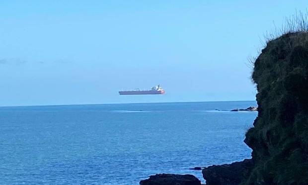

Ship of photographed floating in the air due to local weather conditions,
https://www.theguardian.com/science/2021/mar/05/ship-hovering-above-sea-cornwall-optical-illusion

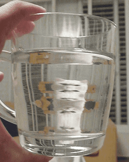

The image is quite impressive but the explanation in the link seems to be incomplete. Where does the gap between ship and water come from?
@etotheipi gave the correct explanatory image. But this experiment with a sugar solution in a glass shows the same physics in a more intuitive way. Note the multiple images, some upside down.

DrStupid said:
That's what I mean. What stops the effect at the waterline of the ship?
I think it's coincidence. The ship happens to be at the right spot.
That's not what I mean. Why does it stop at all?
I presume what we're seeing below the ship is a reflected image of the sky higher up - note that the sky below the ship is lighter than that immediately above it, similar to the higher sky. Perhaps the camera is above one thermal boundary?
Not completely satisfied with that argument.

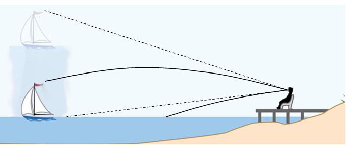

Here's a way that would work:
(edit: refracted ray corrected - thanks to DrStupid in #11)
A layer of warm air (grey) lies just above the sea, extending part way to the ship. Having a slightly lower refractive index than the air above it, there's a potential for an observer above the layer, such as one on land (green), to see a total internal reflection of the sky in a narrow range of angles (delimited by the black rays), with sea at lower angles (slightly refracted as per the grey ray) and the undistorted ship/sky above it. The diagram is obviously Euclidean, but on the curved Earth if the upper black ray were to pass just over the horizon you would see ship but no sea, with sky below it, and sea below that - as in the picture in the OP.
Warm air trapped below cold seems quite unusual, but presumably that's why this is a fairly rare phenomenon. Perhaps it could be warm sea air and then a cold breeze starts blowing off shore over a cliff and trapping a pocket of the warm air? Cornwall is largely granite, so has some fairly abrupt cliffs.

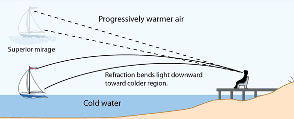

That might be possibe. But would't that be inferior mirage?
The refraction in your image doesn't seem to be correct.
I guess. So either that's not the explanation (although it appears to fit the observations) or the Grauniad has something wrong.
It looked right refracted through my wine glass. Now corrected, thanks.

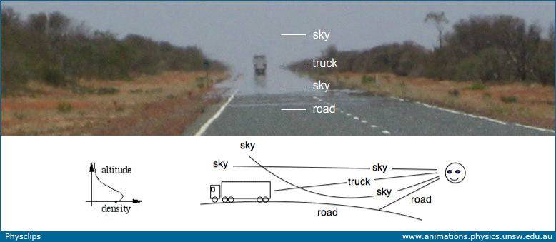

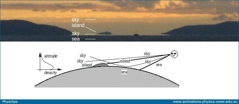

sophiecentaur said:
Also, the examples in post #19 give an image inversion
What are you talking about? The primary clear images of the truck and the island in post #19 are not inverted, because they are seen directly. It's only the sky beneath them that is a "reflection", and on it there might be a faint "reflection" of the object itself.
I'm talking about the case where there is no reflection (I can't see one in the OP) For your scenario, if the sky forms a virtual image below the ship then why is there no inverted image there ? The waterlines are all straight (all example images) but the truck roof is very evident.
There will be several alternative temperature gradients and we need to pick the right one to account for the OP. It is difficult and we need to remember the long distances and the small angles involved. The diagrams all exaggerate the vertical scale. If there is warm air over cold then the curvature of the rays will be downward and, if there is cool air over warm, the rays will be bent upwards. For warm air in a pocket on a road, there can be internal reflection. If there is cold air on the ground, you will only get refraction. Your examples assume warm air below cold air. One problem I have with the cold over warm situation is that the apparent horizon is very straight and your explanation would need very uniform air layers.
If the ships are all beyond the horizon then light from the ships and the sky behind them must be bend downwards (up and over the horizon) so they must appear in the sky above the horizon direction.
