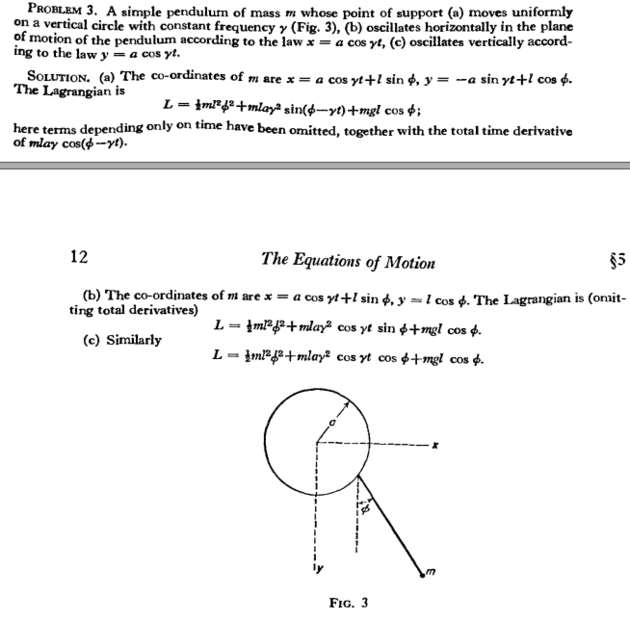

So I've been studying classical mechanics and have come across a small doubt with the solution provided to the problem in question from Landau's book. My question is: why are the coordinates for the particle given as they are in the solution? I imagine it has something to do with the harmonic oscillator, but I'd like to properly understand. I appreciate any kind of help, and I'm sorry if this post is somehow incorrect, it is my first one regarding questions.

Did you look at the figure? For instance in (a), the support point ##p## has coordinates ##\mathbf{r}_p = a(\cos{\gamma t}, -\sin{\gamma t})## and the radius vector from ##p## to ##m## has coordinates ##\mathbf{R} = l(\sin{\phi}, \cos{\phi})## then the coordinates of ##m## are nothing but those of the vector ##\mathbf{r}_p + \mathbf{R}##.

I understand it now, thanks!
