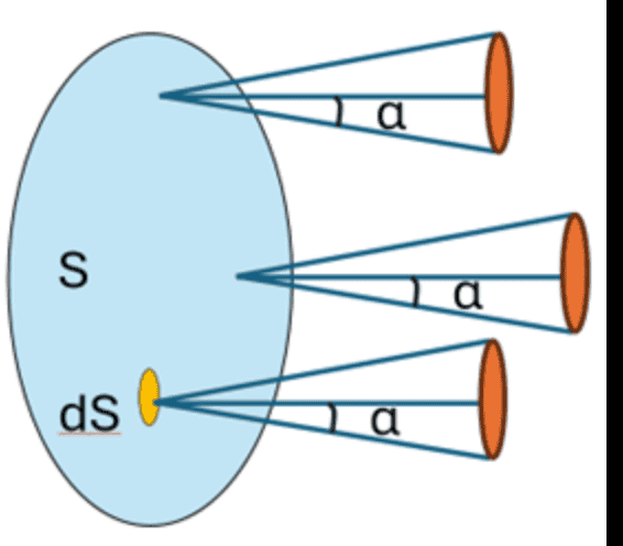

It doesn't just depend on the lens, but also on the light you use. There's something called conservation of étendue.
Étendue is (basically) the area of a light beam multiplied by the angle it subtends (hopefully the diagram I pulled off the internet helps somewhat to explain this - S is the area and alpha the angle). This is a conserved quantity - which basically means you can't make a beam narrower without increasing it's angular spread, or losing intensity, or vice versa.
It's something that is often into account when designing things that require lenses or other ways of manipulating light, as it means that you're not just limited by the lens but in a lot of cases by the light source too - you can't just infinitely "squeeze" or narrow a beam without losing intensity.
It's not a direct answer, but I do hope it helps to satisfy your curiosity! (Do take all of this with a pinch of salt though because I am just a student as well and certainly not an expert)

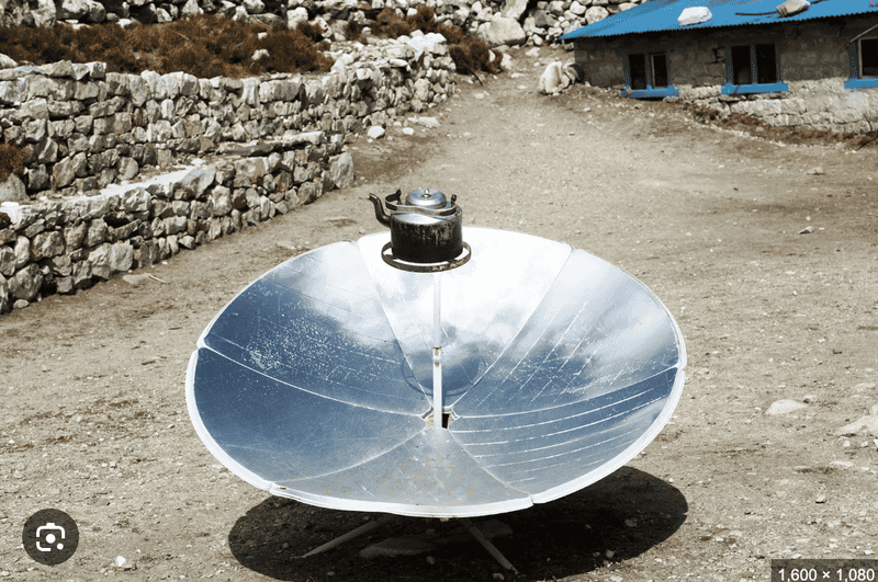

Of course. Here is a picture of a solar oven. Many homes have solar hot water heaters on the roof. Many homes also have passive solar heating. South and west facing windows can go a long way to heating your house. These are not using lenses because no lenses are needed. In cases requiring focusing a mirror is almost always better than a lens.
I've seen many flat panels (full of water) but there's no focussing involved. Heating water to 60C, doesn't require a small spot and it's a lot cheaper
