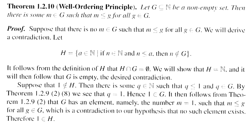

I am reading Ethan D. Bloch's book: The Real Numbers and Real Analysis ...
I am currently focused on Chapter 1: Construction of the Real Numbers ...
I need help/clarification with an aspect of Theorem 1.2.10 ...
Theorem 1.2.10 reads as follows:

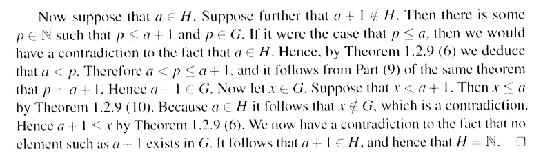

Towards the end (second last line) of the above proof by Bloch, we read the following:
" ... ... We now have a contradiction to the fact that no element such as ##a + 1## exists in ##G##. ... ... "
I do not understand this remark ... as above ##a + 1## has earlier been proved to belong to ##G## ..
Can someone explain the remark "We now have a contradiction to the fact that no element such as ##a + 1## exists in ##G##" in the context of the proof and explain just what is going on ... ...

It is written in a very confusing way. Much too condensed, and no labelling of assumptions to allow justifications to be made clear.
The phrase 'no element such as ##a+1## exists in ##G##' is particularly obscure, because we have no idea what the 'such as' means. It looks like it was intended to mean 'a minimum element', but it did not say that. Also, it should have not referred to the assumption that ##G## has no minimum as a 'fact'. It is an assumption, not a fact.
The statement about the contradiction would be much more clearly written as follows:
'Since ##x## was chosen as an arbitrary element of ##G##, we conclude that every element of ##G## is greater than or equal to ##a+1##, yet ##a+1\in G##. That is, ##a+1## is a minimum element of ##G##. That contradicts our assumption in the first line of our proof that ##G## has no minimum element. Hence we must reject the assumption that there is no minimum element.'
