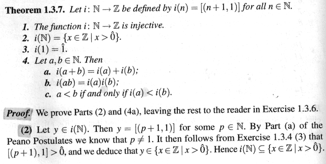

I need help/clarification with an aspect of Theorem 1.3.7 ...
Theorem 1.3.7 and the start of the proof reads as follows:
n the above proof we read the following:" ... ... By Part (a) of the Peano Postulates we know that ##p \ne 1##. ... ... "Can someone please explain exactly how the Peano Postulate (a) implies that ##p \ne 1## ... ?

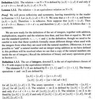

Readers of the above question may well be helped by access to Bloch's definition of the integers as well as Bloch's theorem on the algebraic properties of the integers ... so I am providing both as follows:

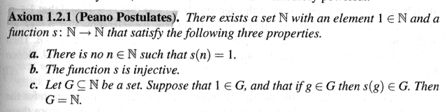

In answer to your Question 2 ... I should have included the Peano Postulates or Axioms ... so here they are ... ...
Apologies for omitting this information ... ...
Thanks. Based on that it looks like the author has made a mistake. He should have written ##p+1\neq 1## rather than ##p\neq 1## (since ##p+1=s(p)##).
Based on this and the previous example from Bloch you posted, I am tending towards mathwonk's view that this may not be a very good textbook, that is going to cause unnecessary grief by the obscurity of its presentation, not to mention mistakes like this.
