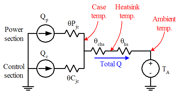

The thermal "circuit" is entirely separate from the electronic one (except that the heat generated is due to the electronic side of things). It's just that you have two heat sources (control and power) dumping heat into the chip substrate which both need to be conducted away via the case-to-heatsink-to-ambient path. Think of it like adding heat currents. The total "current" is the sum of the two heat powers.
I don't understand their model if their example is correct: They seem to assume that the same total power (24 W in their case) is generated by both sections individually since they place that power across both junction thermal resistances. I'd think that the thermal circuit would look something like this:
Perhaps they're modelling some worst case scenario where it is assumed that all the heat is being generated by one section or the other. In that case you'd just pick the higher of the two heatsink resistances for your answer.
