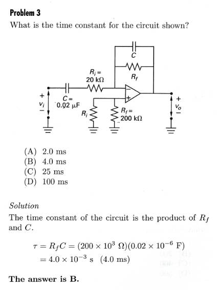

Darn, my editing was me trying to fix my typo’s. I thought I drew the circuit correctly in my attached homework problem but realize my wording in the step 1 was poor. I thought someone could find something on the circuit I drew. Newbies for you. Okay, thanks for responding.
dvscobe - the circuit as shown in the diagram has the following transfer function (bandpass with Q<0.5):
H(s)=sRF*C/[1+s(T1+T2)+s²(T1T2)]
with T1=Ri*C and T2=RF*C
As you can see, there are two time constants which also appear in the step response (continuation of a tangent to the falling resp. rising slope of the step response).
(Question: Are you sure about the given resistor values ? Rather uncommon !).

LvW, I attached a screenshot of the problem here. I guess I should have done this on the original post. This is how I drew it on my first post in my homework though. It does look like a very odd circuit. Notice how there are only three variables, C, Ri, and Rf, but there are 2 of each one. I guess I will need to use a virtual instrument software or something to run this thing and see what it does. I am wondering if the book made a mistake. Is that possible? Dan.

There is a very good reason that they have drawn copies of Ri and Rf connecting the + opamp input to ground. See if you can find the reason in some of the opamp application notes. (They could have just put a single resistor there with a value equal to the parallel combination of Ri and Rf, but it's more illustrative for teaching purposes to show it like that.)
Hint -- add to your search terms: Input Bias Current of Opamp
:smile:
EDIT / ADD -- Actually, since the input is AC coupled with that capacitor, the Ri component in the + input leg should not be needed. Can you say why? :smile:

No, it must not be a mistake. As you can see - the given answer in the book is one of the two time constants I have mentioned. Perhaps they consider this time constant as "primary". By the way - this has, of course, something to do with the DEFINITION of a systems time constant.

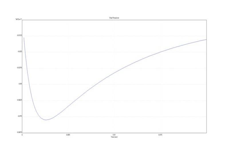

Within the next minutes I will try to show you a step response diagram for your circuit.
Now, I have added a graphic - at t=0 it starts at 1E-18 (which is zero) and it goes back to zero. The step response goes negative because of the inverting nature of the circuit. As you can see, the slops (falling and rising) can help to define two time constants.
EDIT: dvscrobe, some time ago I have asked you about the "uncommon" values as given in your first post. However, I got no answer - hence, for my simulation I have used the values as given in your first post. Only now I have seen that you, suddenly, have mentioned other values (post 10). The step response with these new values will have, in principle, the same form - however, with another time scale.

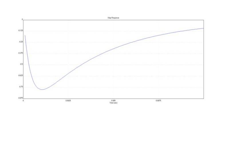

Here is the revised step response with values as given in post 10.
Both time constants (T1=0.4ms and T2=4ms) can be identified in the drawing using the slope of the falling resp. rising part of the curve.

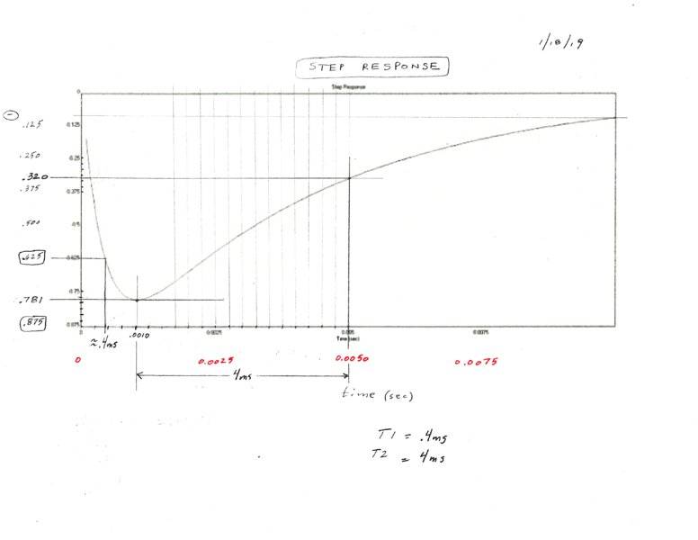

LvW, Oh my! Those curves really helped. Not sure how you plotted that but what this tells me is that your first time constant T1=.4ms of shorter time means that the voltage out will drop rapidly shortly after time = zero, but the second time constant T2=4ms of longer time means the voltage out will go back to zero gradually. Very interesting! I see that in my post #15, I was describing my problem wrong. I will have to get better at learning step response and this post has helped me out with dealing with multiple time constants.
