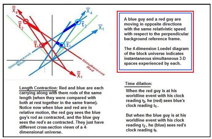

What? That's a little confusing, ghwellsjr. Why not use a block universe Loedel space-time diagram--it becomes clear that each sees the other's clock ticking more slowly (time dilation). And you get a two-fer--length contraction comes along for free in the diagram.
The OP is not confused that Time Dilation happens for a moving observer. He realizes that dilation means expansion, not contraction (like is true for lengths). He is confused by how time dilation results in a moving observer aging more slowly than a stationary one.
I did not mean to detract from phind's excellent answer, only to point out that it takes longer for the moving observer to reach the point where he needs to choose a burial plot than it takes for a stationary observer. This is the sense in which time dilates (expands, gets bigger, takes longer) for the moving observer. Seconds take longer, minutes take longer, it takes longer to get to your next birthday, everything takes longer.
