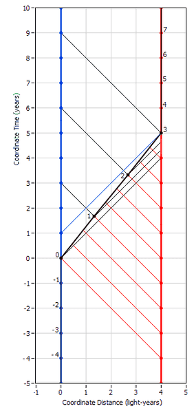

I have made some drawings to show what is happening in this scenario according to the two Inertial Reference Frames under consideration. First, the IRF in which the Earth and AC are at rest:
I have put in numbers in black to show the time on the travelers' clock.
I have also drawn in signals that travel at c to indicate what each observer sees of the other ones. At time 0, Earth (blue) and the travelers (black) see AC (red) at -4 years. After the travelers reach their speed of 0.8c, Relativistic Doppler takes over and they see the clocks on AC advancing at 3 times their own so that in the 3 years it takes them to get there, AC's clocks have advanced by 9 years, taking them from -4 to 5 years, as has already been noted. When the travelers look back at the earth, they see its clock ticking at one third the rate of their own so after 3 years, the Earth clock has advanced by only one year. This one year, plus the three years it took to get there account for the four-year difference in time that AC sees of Earth's clock compared to their own. The now "stationary" travelers see a 2-year (instead of a 4-year) difference in their time compared to Earth because they "lost" 2 years during the trip.
Also, during the trip, Relativistic Doppler applies for what the Earth sees of the travelers. Earth will see the travelers' clocks running at one-third of their own so it will take 9 years for Earth to see the travelers arrive a AC. This 9-year difference minus the 3-year advance results in Earth seeing the travelers' clocks earlier than their own by 6 years instead of the 4 years that they see of the other inhabitants of AC's clocks.
And finally, AC sees the travelers leave Earth when their own clocks read 4 years, as was pointed out, and in one year, they see the travelers clocks advance by 3 years so that when they get there, the time will be 5 years according to their own clocks, but the travelers clocks will be at 3 years. This 2-year difference will continue between the travelers' clocks and the other clocks on AC.
Note that this entire analysis was done in a single IRF.

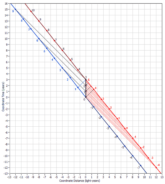

Now if we want to see what it looks like in another IRF moving at some speed relative to the first IRF, we can use the Lorentz Transformation to convert the coordinates of all the significant events in the first IRF and draw another graph. We will do this for a speed of 0.8c so that the travelers will be at rest when they start their trip:
Now you can see that the distance between Earth and AC, measured between two points at the same time, is 2.4 light-years as was pointed out. You can also see that the same Relativistic Doppler factors apply, each observer seeing the same things they saw before.
To help in identifying the time on the various clocks, I have shown them in black for the travelers for the entire scenario but only for about half the scenario for the Earth (blue) and AC (red).

No. If you look on the second graph, you can see that AC was 12 light-years away at the time the -4 year signal was sent.
The question of "now" only makes sense for a remote clock that is at rest with respect to the observer for two reasons: first if there is relative motion then the two clocks tick at different rates so if there ever was a moment that could be identified as "now" for both of them, it would only apply for that one instant in time. Secondly, since the way to synchronize two clocks is by sending a round trip signal between them, the remote clock will have moved during the process and how could you identify which position "now" applied to?
You should realize that the question of "now" between two separated clocks is not one that we can derive from nature. We inject into nature what "now" means and the way Einstein says to do that is to send a round trip synchronizing signal between the two clocks. That is going to take at least 8 years in this example. Now you might say that we really don't have to do that since we know how far away the other clock is but there is no way to even know that short of measuring it with a round trip signal so we're in the same situation.
So how do the travelers know that AC has moved from 4 light-years away to 2.4 light-years away after they start their trip without cheating and calculating it just like we did here? Well, they would have to send that round trip signal. Look at the graph. A signal sent by the travelers at time 0 will arrive at AC when their clocks read 4. (Follow the thin black line going up and to the right from the zero location at a 45 degree angle.) Now AC responds with a signal back to the travelers which the travelers will detect when their clocks are at 2.667 years and they are very close to AC. So they will conclude that AC was 1.333 light-years away and it was at the half way point between the start and end of their test. But what they wanted to know is how far away it was when they started their trip. Can you figure out how they would make this assessment?
It might be interesting to see how Earth determines how far away AC is in the second IRF. If they send the same signal that I discussed in the previous post that arrives at AC when their clock reads 4 years, then track how the response gets back to earth, I think you can see that it will arrive on Earth when Earth's clock is at 8 years. So Earth will conclude that AC is one-half that distance the light has traveled or 4 years. And you can see that Earth will see that their clocks are synchronized because the return signal claims that it is 4 years earlier. We are assuming that the signal include the time the signal was sent.
In the same way, AC can determine that Earth is 4 light-years away and that their clocks are synchronized by the signal it sends when its clock was at -4 years and receives the response back from Earth at +4 years saying that the Earth time was zero.
