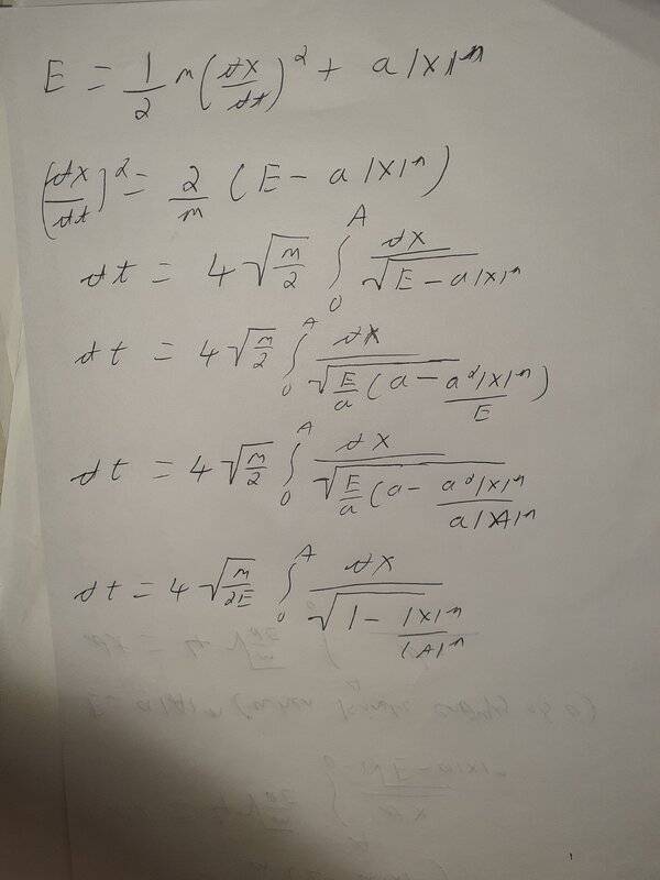

Given is the potential energy of the harmonic oscillator: U=a|x|^n, amplititude is A
Find the time period of this harmonic oscillator
E=(1/2)m(dx/dt)^2 + a|x|^n
Your result is written as
[tex]4A\sqrt{\frac{m}{2E}}\int_0^1 \frac{dx}{\sqrt{1-x^n}}[/tex]
where amplitude A is
[tex]A=(\frac{E}{a})^{\frac{1}{n}}[/tex]

No, I have'nt written 4A. It's 4. A is inside the root in the denominator.
But how do you solve that integral?

I made a replacement of x/A ##\rightarrow## x.
The definite integral is a function of ##\Gamma## functions of ##\frac{1}{n}##.

Harmonic oscillator in classical physics are not systems subject to an force/ente proportional to its "displacement"? So n shouldn't be two?
Or it is not a harmonic oscillator?
As noted by LCSphysicist (#6), this is NOT a harmonic oscillator (except when n=2). The word 'harmonic' is specifically used twice. Is there a possibility this is a 'trick' question?
A harmonic oscillator is one which has a restoring given by:
##\vec F = -k\vec x ##
If I were answering I would demonstrate that only n=2 gives a harmonic oscillator. (Hint, what is the relationship between ##\vec F ## and U?)
Then express in the usual SHM equation format:
##\frac {d^2 x }{dt^2} + \omega^2 x = 0##
You then get the period from ##\omega##.
