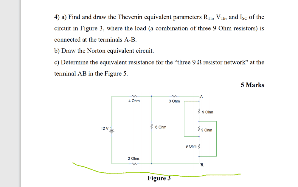

1.whats the equivalant circuit for circiut shown in figure 3???????
2.how can we determine the Thevenin parameter for question 2?????
mesh/nodal analysis

Hi asd852, Welcome to Physics Forums.
We can offer help only after you've shown your own efforts so far. What have you tried?
I am a bit clueless
asd852 said:
I am a bit clueless
Then you have taken on a problem that is too advanced for you. Go back and study the basics.

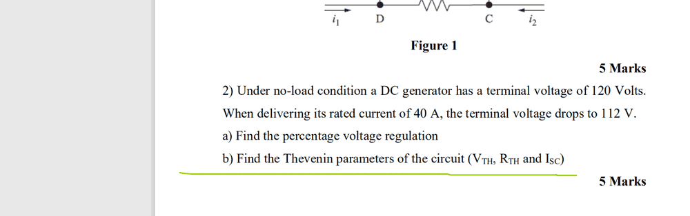

asd852 said:
Homework Statement:: 1.whats the equivalent circuit for circiut shown in figure 3??
Relevant Equations:: mesh/nodal analysis
Seeing that you're new to PF, a bit of help.
For the problem you show (Question 2 with Figure 3):
Consider the circuit with the 9 Ω resistors removed from terminals A and B.
For Question 2: Make a new thread, showing the attachment as full size. Above all, show an attempt and/or be specific about what is confusing to you and what you do know.
There are some good explanations on the web of Thevenin's theorem as well as YouTube videos. I suggest you look into those, try to apply those methods to your problem, and come back here with questions about the confusing bits if you need to. Sometimes you need a different explanation than the one you got in class, or you just need to hear it a few times.

One more try with clues to assist you.
You have probably been told that any points connected by a wire are at the same potential (voltage), at least I hope that was part of your curriculum!
Keeping that in mind, look at the junction between the upper two 9 Ohm resistors.
Can you say what the voltage is there, and why?
If that helped any, pretend the drawing is on a sheet of rubber that you can stretch out of shape. Now mentally drag the common point of the two upper 9 Ohm resistors to a position that makes more visual sense for you.
If you have gotten this far, please post a sketch of the re-arranged circuit.
Cheers,
Tom
(Hang in there asd582, the exercise you were given is designed to be somewhat confusing, and to get that "AH HA" moment in your head when you realize the solution.)

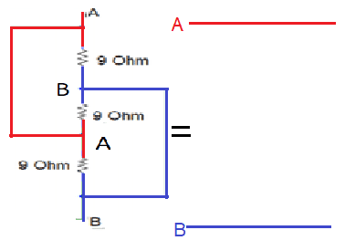

A picture may help.(two points connected with a viire are the same point in the circuit. )
Which resistors are connected to point A ? And to point B?

You get this sort of problem when drawing schematics from PCB traces. My technique was to colour each track, so that wherever it reached, I could see from the colour what it was connected to.
This one is trivially easy, because you use only two colours.
In this case I'd put the A track (red) across the top and B track (blue) along the bottom. Then just put the resistors wherever they'll fit neatly, with their ends connected to the right colour.
Merlin, that's a good technique but I think we've given hints aplenty with no response from the OP to them. So now, let's wait until he shows some effort in using what we've already provided.
