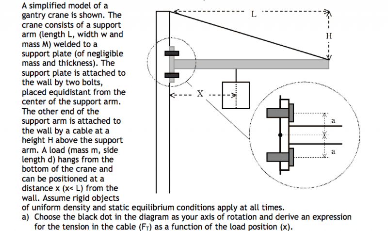

Diagram of a gantry crane: a horizontal support arm of length L attached to a wall, braced by a cable from the wall at height H, with a hanging load at distance X from the wall; an inset shows the two bolts and the pivot point.
Static equilibrium: Net force & net torque = 0

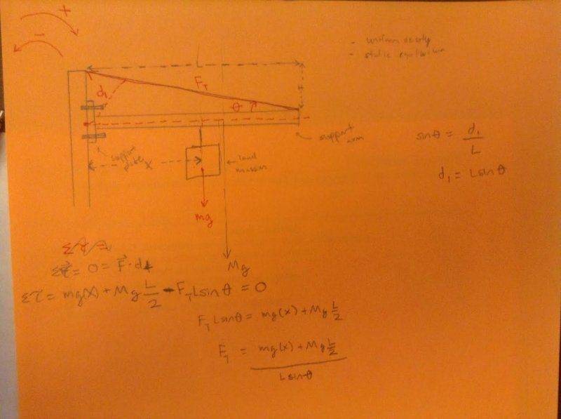

Handwritten free-body diagram on orange paper of a horizontal support arm braced by a diagonal tension cable F_T at angle theta, with load mass mg hanging at distance x and uniform beam weight Mg, followed by torque equations solving for F_T = (mg x + Mg L/2) / (L sin theta).
Am i doing this correctly for part a? [/B]
Are we to assume that there are no forces on the bolts?
You are introducing an extra quantity d1 into your calculations, which will be difficult to calculate. Find an expression for sin θ based on L and H for the gantry crane as shown in the diagram.

Either way even with replacing d1 with H, I still get Ft = (mgx+MgL/2) /(L sin(theta) ) . Am I on the right step?

d1 ≠ H, and the expression for sin θ is a little more complicated than that. Your expression for FT is correct.

If I can't call the line of the pivot point perpendicular to the cable d1, what should I call it? I'm a little confused on what you mean. Isn't that all I'm looking for anyways: the tension in the cable as a function of the load position x? - which was the expression i found?. :/
Yes, it's absolutely fine. But can you express sin theta in terms of H and L ?

Yes you would get sin(theta) = H/L ----> H=Lsin(theta). So then my final answer would be Ft = (mgx+MgL/2) /(L sin(theta) ) ----> Ft = (mgx+MgL/2) /(H). Much better I hope? :]

There's another triangle (which you are overlooking) which can give you an expression for sin θ. (Hint: the cable holding the support arm forms the hypotenuse of this triangle)

The only triangle I see is the top triangle and bottom triangle and the triangle on the left with d1.
sin theta = H/L
How else can you derive the sin theta?

sin θ is not H / L. You should review your trigonometry, especially the definitions of the sine, the cosine, and the tangent.

Sorry about that, sin theta = H / sqrt (L^2 + H^2) :D
