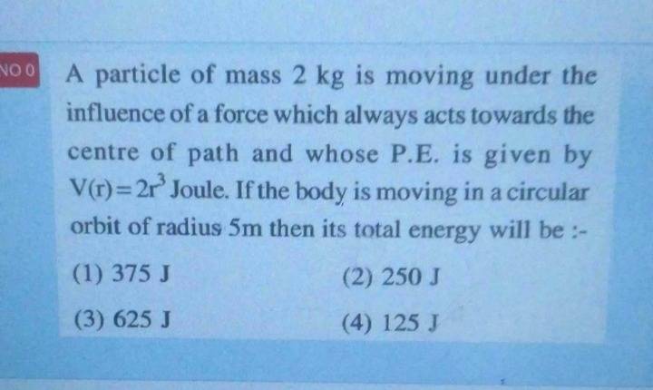

Total energy of a body in a circular orbit
In a circular orbit, a particle is influenced by a single central force, resulting in zero work done by the force since it always acts towards the center. This leads to the conservation of energy, allowing for the determination of potential energy at a specific radius. The centripetal force derived from the potential field is responsible for maintaining the circular motion of the object. The challenge lies in calculating the kinetic energy of the particle. Understanding these principles is crucial for solving problems related to total energy in circular orbits.

Is the particle moving under the influence of a single central force ?
Since the force always acts towards the center , work done by the force is zero . Energy is conserved . Potential energy at a particular radius can be found . But how do we find the kinetic energy of the particle ?
The force from the potential field is the centripetal force that makes the object follow a circular path
Thanks !
