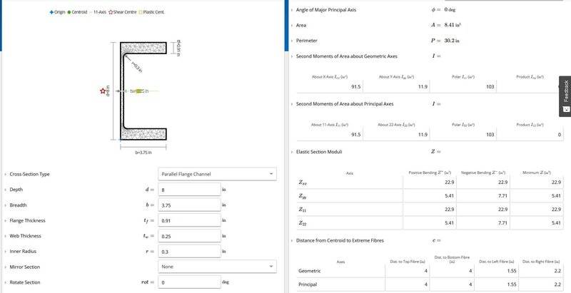

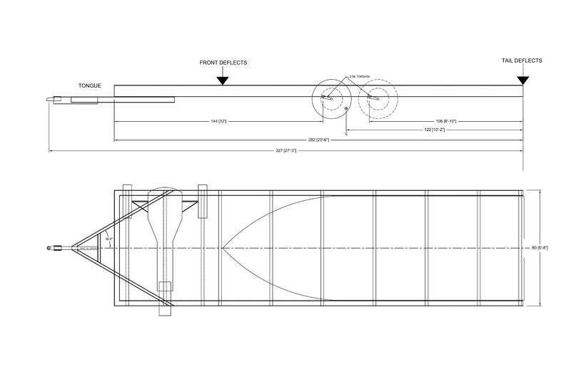

Building a trailer. Beam calc's ask for (I) - section calc's give me (Ix) & (Iy)???? Which do I use?
I'm building an aluminum tandem axle (7k total capacity) trailer. Boat (18'/1300#) on the rear and a Ryker Can Am 3 wheel (750#) on the front. It's a 23'-6" x 6'-8" bed. Max live load will be approx 2250#. 900# frame weight. 230# axles.
I'm testing beam sizes with online calculators and need some help.

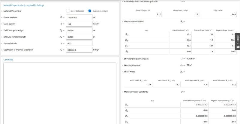

I'm using a "section properties" calculator to find the Moment of inertia. https://calcresource.com/cross-section-channel.html
I'm using a "cantilevered beam" span calculator for the span distance from back axle to the rear. https://calcresource.com/statics-cantilever-beam.html
And a "simple span" for the distance of front axle to trailer tongue. https://calcresource.com/statics-simple-beam.html
My beam span calculators require Length (L) - Youngs modulus (E) - and Moment of inertia (I). My section properties calculator is giving me Moment of inertia in (Ix) and (Iy) and (Iz). I'm using the (Ix) number in the beam calc box for (I).
My questions: 1. Is using (Ix) correct? Or do I add Ix and Iy together? 2. Do these calculators typically use member self weight in their calc's?
I'm mainly looking for the deflection criteria. I'm trying to keep that under 0.15" (with load). The boats CG is over the axle center so tail bounce should not be a problem. Torsional movement (Iz) is almost non-existent with the cross bracing member size, spacing, and diagonal bracing I've used. The axle system is sliding/adjustable. So I'll be able to tune the tongue weight close to perfection by adjusting the axle location. That should greatly reduce any major lateral instability while towing.

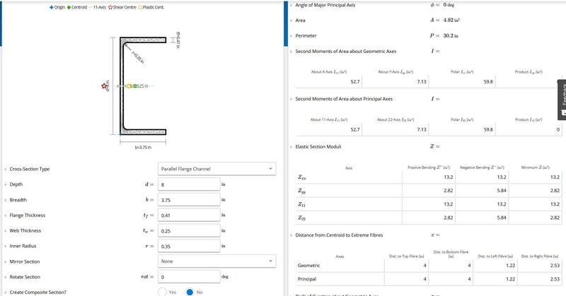

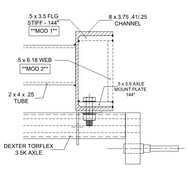

My current choice is an Aluminum Association Channel 8x3.75 - 0.41tf/0.25tw.
Cantilever = 106 in - (69MPa) - MoI 52.04 in^4 - 40# uniform load = (0.101 deflection @ 116")
Simple Span = 144 in - (69MPa) - MoI 52.04 in^4 - 35# uniform load = (0.031 deflection @ 82")
The 32" between axles was ignored. Channel bottom flange is being reinforced with a welded 3/8"x3" sliding axle plate for the center 86" of the total bed length. Both spans are getting that extra moment support and it's not incl in calc. Adds an additional safety factor. The tongue is an A frame that goes under the side channel adding support for another 20% of the front span.
If anyone thinks I'm over designed please let me know why. Aluminum prices are crazy high right now.
Thanks

Two-view engineering drawing of a tandem axle trailer: side elevation with labeled dimensions 327 [27'-3"], 282 [23'-6"], 122 [10'-2"], 144 [12'], 106 [8'-10"], and front and tail deflects marked, plus top plan view with tongue, A-frame and 80 [6'-8"] width callout.
I'm curious why no one can answer my question? Did I do something wrong here?
We’ll, it’s a bit to take in, but personally I didn’t see it until today. 3D loading on a system of beams is a trickier to deal with computationally by hand. There are also dynamic loads also to consider. I’ll see if I can come up with a reasonable approach.
Ignore the torque on the beams from the eccentric loading and the tie down rigging to get a first order approximation of the loading.

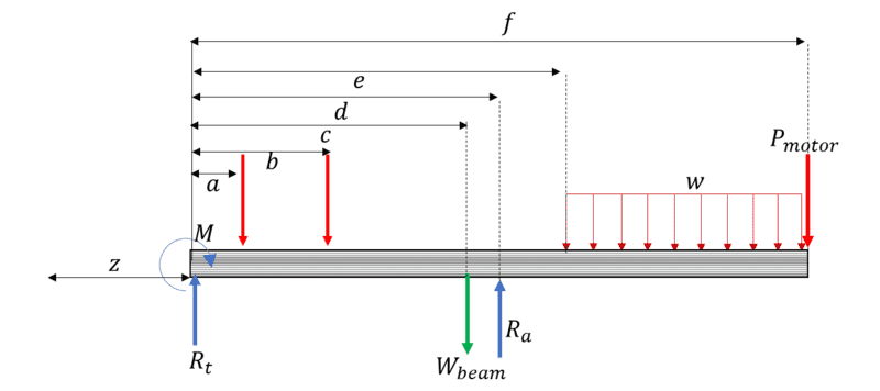

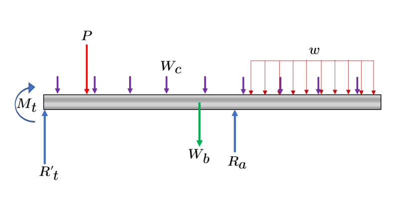

From your diagrams this looks to me like:
Free-body diagram of a horizontal beam showing downward point load P, distributed load w, crossmember loads Wc, beam weight Wb, upward reactions R'_t and R_a, and a moment M_t at the left end.
##R'_t## is the reaction at the tongue divided by 2
##M_t## is the moment from the reaction at the tongue applied to the beam ##M_t = 2 R'_t d##, where ##d## is the perpendicular distance between the tongue and the frame.
##R_a## is the reaction at the axle (solve for ##R_a## in the most forward position)
##P## the weight of the ATV.
##w## is the distributed load from the boat (load per unit length), (with gear etc...)
##W_b## the weight of the beam
##W_c## weight of the crossmembersBy the way, these are all "half loads". (except the weight of the beam ##W_b## and the moment ##M_t##)
You need to solve for the reactions ##R'_t, M_t,R_a## using ##\uparrow \sum F = 0## and ##\circlearrowright \sum M = 0##.

After you get the reactions, the graphical approach is to plot Shear/Moment diagrams, with the goal of determining the moment as a function of spatial coordinate ##x## acting along the length of the beam.
Then, the elastic curve is given by:
$$ EI\frac{d^2y}{dx^2} = M(x) \tag{1}$$
The maximum deflection in the beam is found by setting ##\frac{dy}{dx} = 0##, solving for ##x##, and substituting that into ##y(x)##.
*Note* It's best to use singularity functions ( as opposed to a graphical solution ) for this because of the many discontinuities in loading along this beam. If doing it graphically you would need to solve for a different ##M(x)## between each discontinuity (point load), and solve (1) over each domain, using initial conditions from the last domain. It would be tedious us work to say the least.

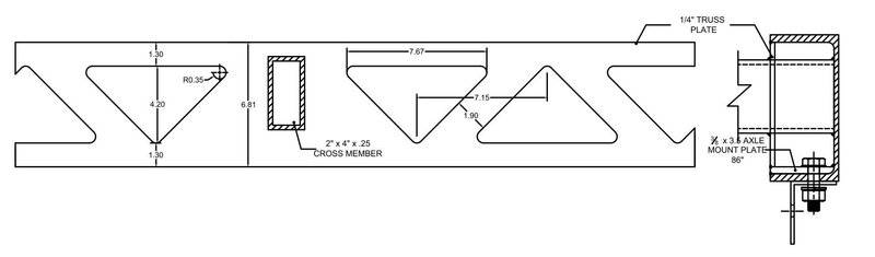

Thank you very much. I apologize that you went to that much effort. I took a shot at completing that calc but it's beyond my abilities. I've called a few local engineers to see if I could pay them to size the beam for me. No seal, just a verbal recommendation with no liability. They were hesitant and I understand why.
Can you tell me if using LX is correct in my question?
And is locating my 2" oc bolt pattern in line with the beam centroid a problem. (see drawing) Would it be better to offset from the centroid?
With personal projects in the past I've just checked span capacities with a uniform loading and added a CYA size up to obtain minimum deflection. I know that's not the best approach but all I have right now. The front span doesn't worry me. It will have an aluminum deck that will lateraly tie all the framing in the first 7'.
It's the tail end cantilever that has my concern. In "half load" the beam will have to carry 40#/LF over 9.25 LF. Cross members only add 5# every 3'. My axle system is sliding. If need be I can slide the axle farther to the rear to compensate.
I don't think moment is going to be an issue when the trailer is loaded. With boat trailers the boat tie downs turn the boat hull into a frame stiffener. And the boat tie down at the bow actually creates a counterweight using the boat as a beam. It's not a significant addition but it reduces tail bounce. Moment when it's empty is what I looked at and it's more than acceptable.
I have a 3/8"x3"x 86" axle plate making my bottom flange thickness 7/8" ttl and it extends 46" fore and aft of the axle location. I'm hoping that and the web stiffeners I've added will give it additional strength.

That was the toughest part of the design. Running multiple scenarios of loading and finding the the right match for a 10 to 15% tongue weight. https://www.engineersedge.com/calculators/trailer-weight-balance.htm
I designed this trailer for my motor home. I want my boats when I travel and I need transportation when I park the motor home.
When the flats boat comes off the trike is loaded from the rear and moves to where the boat is. The bunks for the boat will match the trike wheel base.
When the trike is removed the winch post for the boat slides forward up to 26". 21" is what I calc'd for a 12.5% tongue weight. I'm using airline track with 1" incremental slots.
In odd conditions or different loads my axles can slide 22" forward or backwards from center position in 2" increments. I did that so I can leave the salt water flats boat home on cross country trips. I'll carry my inflatable skiff and the trike. That load requires moving the axle location.

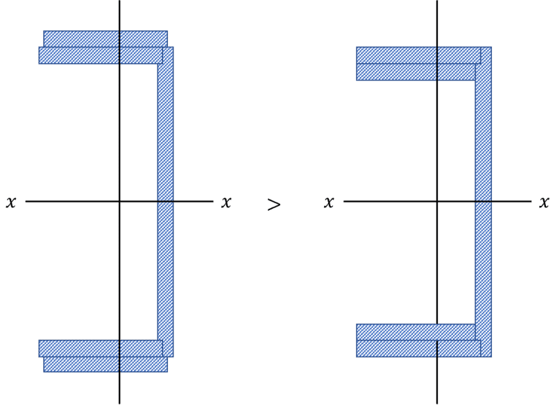

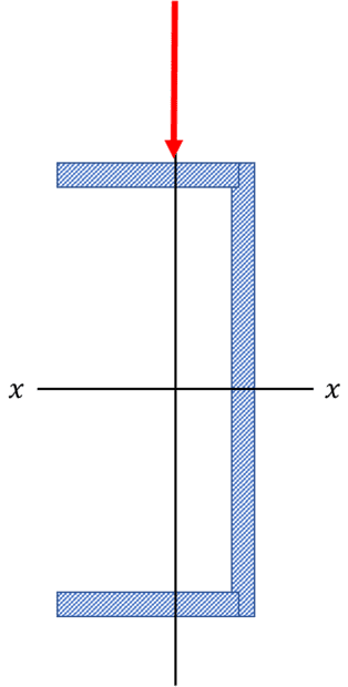

If the beam is loaded like:
Cross-section of a channel-shaped beam, drawn as a C with flanges at top and bottom, hatched in blue. A red downward arrow hits the top flange. A horizontal axis labelled x-x runs through the centre, and a vertical centre line runs through the section.
You are considering bending moments about axis ##{x-x}##, thus ##I_{xx}## is the appropriate moment of inertia to use.

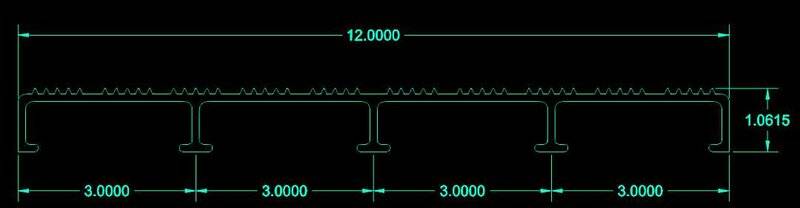

My objective was to use rectangular tube. Either 2x5x.25 or 2x6x.25 (6061 T6). The 8" channel was what fit the load numbers I came up with while 'fumbling' my way through this design. It's not a good match for the welded joints at mid span of the web, but it met the load.
Tube gave me a stronger and cleaner weld condition. And it simplified my sliding axle design. I was also using the tube frame as a water reservoir for my brake wash down system. Salt water eats brakes.
The trike loading 'T' is mostly concentrated in the front center of the trike body. So I would say each front wheel is just under a half load. About 285# ea wheel. They are sitting approx 5" in from the beam edge and directly over cross members. The rear wheel isn't carrying any more than 75# and sits directly over a cross member. The area the trike sits on is an extruded aluminum decking that is perpendicular to the cross members. It's clipped to the cross members at the butting edges. And it gets a 1/4" bolt mid span of the cross members in the butt joint of the vertical leg. I'm assuming it's adding to weight distribution with it's lateral attachment?
Cross-section drawing of an aluminum deck extrusion with four hollow channels, each spanning 3.0000 between supports, totaling 12.0000 width and 1.0615 height.

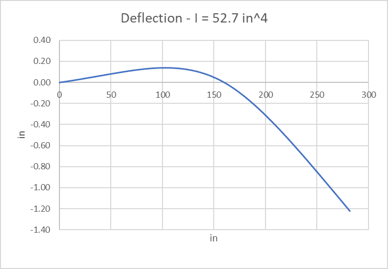

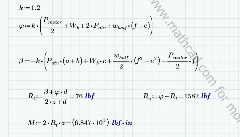

I have no expertise in structural engineering and or trailer design and the dynamic loads ( @tech99 post #17 points out) they might experience under normal operation, and this is not a validation of the overall trailer design in any way. This kind of structure and 3d loading is much better suited for FEA software. You know how to draft, so perhaps just get a license and learn to the basics of that software would be better comprehensive analysis. As others have said, you'll have to ensure your design meets regulations (federal and/or state) and whether or not the trailor and the load can be insured given self design/manufacture. See @ChemAir response #21.
That being said, here is what I get:
#Note#: The beam is actually statically indeterminant due to the dual axle system. That would require more computational analysis that I'd like to go through. I've combined the tandem axle reactions into a single reaction at the central location between axles.
Free-body diagram of a beam with a fixed end at left, showing reactions R_t and R_a, moment M, point loads from wheels and P_motor, uniform load w, and beam weight W_beam, with distances a through f marked from the left end.

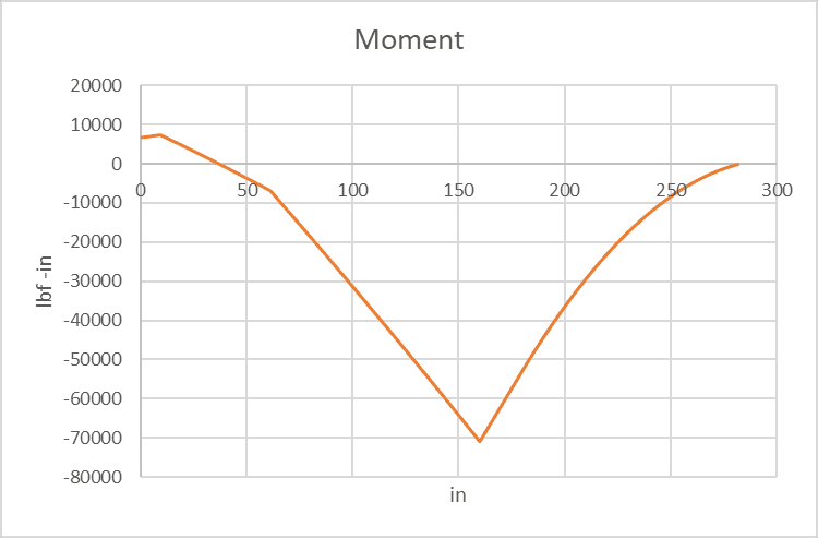

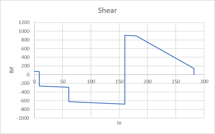

Here are the parameters I used: I gave a dynamic load factor of 120%
Excel spreadsheet listing beam design inputs: lengths a through z in inches, dynamic and static loads in lbf, a dynamic load factor of 1.2, modulus of elasticity 10.1E+06 lbf/in^2, moment of inertia 46.13 in^4, and integration constant C1 = 743422.
Here are the resulting Shear/Moment/Deflection Diagrams:
Line graph titled Shear plotting shear force in lbf against position in inches from 0 to about 285, showing step drops and a sawtooth-like profile with a sharp jump near 160 in.
Line graph titled Moment, plotting moment in lbf-in against position in inches from 0 to 300; the curve starts near 7000, peaks slightly, falls to a minimum of about -71000 near 160 in, then rises back to 0 near 280 in.
Line graph titled Deflection, plotting in against in: the curve rises slightly to a peak near 0.16 around x = 100, crosses zero near x = 160, then falls steadily to about -1.40 at x = 282.
Here are the equations that produced them:
$$\begin{align} V(x) = R_t - \lambda x - P_{atv}\left< x-a \right>^0 - P_{atv}\left< x-b\right>^0 + \tag*{} \\ R_a \left< x-d\right>^0 - w \left< x-e\right>^1 -\frac{P_{motor}}{2} \left< x-f\right>^0 \tag{shear} \end{align}$$
$$ \begin{align}M(x) =M+ R_tx - \frac{1}{2} \lambda x^2 - P_{atv}\left< x-a \right>^1 - P_{atv}\left< x-b\right>^1 + \tag*{} \\ R_a \left< x-d\right>^1 - \frac{1}{2}w \left< x-e\right>^2 \tag{Moment} \end{align}$$
$$ \begin{align} y(x) = \frac{1}{EI} \left( \frac{1}{2}Mx^2 + \frac{1}{6}R_tx^3 - \frac{1}{24} \lambda x^4 - \frac{1}{6}P_{atv}\left< x-a \right>^3 - \frac{1}{6}P_{atv}\left< x-b\right>^3 +\tag*{} \right. \\ \left. \frac{1}{6}R_a \left< x-d\right>^3 - \frac{1}{24}w \left< x-e\right>^4 + C_1 x \right) \tag{Deflection} \end{align}$$
The deflection was solved with initial conditions ##x=0,y=0##, ##x=d, y=0##. Which yields for ##C_1##
$$C_1 = \frac{1}{d} \frac{P_{atv}}{6} \left( (d-a)^3 + (d-b)^3 \right) + \frac{1}{24}\lambda d^3-\frac{1}{6}R_td^2-\frac{1}{2}Md$$
Here are the reaction equations:
Mathcad worksheet of beam load equations: k := 1.2, phi = k(P_motor/2 + W_b + 2·P_atv + w_half·(f − e)), beta = −k(P_atv·(a+b) + W_b·c + w_half/2·(f² − e²) + P_motor/2·f), Rt = (beta + phi·d)/(2·z + d) = 76 lbf, Ra = phi − Rt = 1582 lbf, M = 2·Rt·z = (6.847·10³) lbf·in.
Thanks! Can't tell you how much I appreciate your time on this. And I agree that anything you're helping me with is totally and unquestionably hypothetical.
One last question. In your 'parameters', is the M.o.i. (46.13) what I need to exceed or is that the M.o.i of the member you tested? The reason I ask is because your deflection graph show's -1.4" at the tail end? Wouldn't that be considered excessive? I've been trying to stay under 0.25". Am I being to strict with that requirement?
Thanks again.

The M.o.I is for the C channel that you specified( 8x 3.25x.41x.25). I just rough calculated it though, if you have an exact value from the manufacturer, we can use that. I didn't notice that you had given 52 in^4 in the OP, is that the manufacturer spec?
It's hard to tell. The normal stresses in the beam are not very high ( S.F. ##\approx## 5 on material yield stress ignoring forces from the second axle, and combined torsional loading effects present). The stresses are what determine the cycles until fatigue failure for the beam...so having the average stress low is a good start.
As for the deflection, I would try to tame it by boxing the beam with some flat plate in a good location. My gut is telling me about a few feet on either side of the axles would help ( if you could imagine taking your finger and pushing the curve down toward zero close to the 150 inch range it seems like you could do some damage to the tail deflection issue), but I haven't computed anything (its tedious business to compute with the moment of inertial changing along the beam).
It's likely that the assembled frame is stiffer than just the beams. How much...going to have to consult FEA on that. The issue with not trying to stiffen the beams is if it is deflecting under that load, then whatever is tied to it is going to act like a stiffener i.e. your boat in this case. So, while it may not deflect as much, that trades off with the stress of the load being carried partially by the boat. I don't know if that is a good trade?
"The M.o.I is for the C channel that you specified( 8x 3.25x.41x.25)." The channel is a 3.75 flange not 3.25.
Supplier sent standard spec's on 6061 T6 Architectural Structural. I also used this link for 6061 T6 spec's. ASM Spec's
I used a online calculator online for MoI. (I think I'll buy the basic version of that calculation software. I emailed them with questions because it has limited database & use for Aluminum members)
Cross-section diagram of a parallel flange channel beam with its properties table, showing depth d = 8 in, breadth b = 3.75 in, flange thickness 0.41 in, web thickness 0.25 in, inner radius 0.35 in, and computed section properties.
Screenshot of a structural beam calculator showing material properties for 6061-T6 aluminum, including elastic modulus 10,000,000 psi, density 169 lbm/ft3, yield strength 40,000 psi, and Poisson's ratio 0.33, with section property tables.

I kept in mind the ^ force between the axles (32" span). I can't box the beam like you suggested but I have an idea shown below. I need access to the axle bolts.
An option, in lieu of boxing, I added a 3/8" x 3" plate to the top and bottom flanges (inside the channel) for 86" (centered on the 32" axle span). That means the flange is stiffened for 27" past the axle/beam connection. Weak axis stiffening ... but it's all I had.
After adding the (2) 3/8" PL's I did an MoI on a 8x3.75 .785/.25 Channel. That gave me an 83 Ixx / 10.8 Iyy / 93.8 Izz. Taking that into consideration ... I "think" the ^ force & moment at the axles and the rear cantilever are going to be ok?
I'd really rather box that channel like you said and leave the 3/8" plate off the top flange. It gets in the way for welding the top of the cross member. I'm considering a truss type 1/4" plate to box it with the 3/8" axle PL on the bottom flange for the axle bolts. That truss configuration will give me wrench access to the bolts. It's such a bastard design that I can't put it into an online calculator.
As a guess??, your thoughts on the truss & bottom flange PL combo being too weak to actually add substantial stiffening?
Engineering drawing of a truss-style trailer beam with triangular cutouts and dimensions 1.30, 4.20, R0.35, 6.81, 7.67, 7.15 and 1.90; labelled 1/4 inch truss plate, 2 x 4 x .25 cross member and 3/8 x 3 axle mount plate, 86 inch length.
Whoops...easy fix. It looks like using ##I_{xx} = 52.7 \rm{in^4}##:
Line graph titled Deflection - I = 52.7 in^4, plotting deflection in inches on the vertical axis against position in inches from 0 to about 280. The curve rises slightly to about 0.14 near 100 in, crosses zero near 160 in, then falls steeply to about -1.22 at the end.

Why that doesn't work is because the beam can have discontinuous shear and moment, it cannot have discontinuous slope and deflection. The online calculators you will likely encounter have built in constraints on slope and deflection for a particular set of loading/end conditions.
For instance a simply supported beam, there is not a constraint on slope at the supports, there is a constraint on the deflection ( i.e. at the supports y= 0 ). For a cantilever beam there is a slope constraint and a deflection constraint at the fixed end.
All hope is not lost though. You don't have to solve the equations as I did. Because of the linearity of the governing differential equation, the principle of superposition can be applied(partial solutions can be added to get the entire loading solution).
You analyze the entire beam under each load (by itself).
https://awc.org/wp-content/uploads/2021/12/AWC-DA6-BeamFormulas-0710.pdf
In the linked PDF figures 19,20, and 21 describe your loads ( figure 18 as well if you include the weight of the beam as a uniform distributed load )
So in order to get the free end deflection of a combined loading you add all the ##\Delta x_1##'s from each loading.
Again, this is applicable to beams of constant section properties ##E## and ##I##, if you start changing them mid span the equations don't hold.
My gut says increasing the M.o.I where the slope of the unreinforced beam is changing the most, has to be a good thing for decreasing that free end deflection. However, you won't be able to use the equations in the linked PDF to analyze the effects of the reinforcement. To do that, you would have to break the beam up in to sections containing/not containing the reinforcement, and get the integration coefficients for each section simultaneously subject to slope/deflection criteria (meaning no sudden changes in slope or deflection along the beam).
I can't be precise with that complex geometry, its certainly not going to hurt if that is what you prefer. Would you just be trussing the 86 inches centered over the axles?
EDIT: Just for a ball park, if the plate was solid 0.25", the M.o.I only goes up to about 60 in^4. Paneling that over the whole beam only reduces the deflection by a 0.1 in. That juice isn't worth the squeeze.
You need to add material above and/or below the neutral axis as far as you can. Is there going to be any short side rail on top of the beam?
I've been reviewing my material list and I need 1/2" x 3 1/2" plate for my tongue. And the stock lengths in material will leave me with long drops. I looked at the price and it's cost effective to just use 1/2" everywhere and change out the 3/8" to 1/2" and go 144" from the rear end forward instead of 86" centered.
If I add the 1/2 x 3 1/2 to the top and bottom flanges I get a 91.5 MoI.
Screenshot of a beam section calculator showing a parallel flange channel cross-section with depth 8 in, breadth 3.75 in, flange thickness 0.91 in, web thickness 0.25 in, inner radius 0.3 in, and section properties including area 8.41 in squared and Ixx 91.5 in^4.
I've come to realize I can only get 'close to' with a calc on this build. I worked in the pre-engineered metal building industry for 15 years. This thing is a pre-engineered beam candidate. I'm going to use my "call a friend" life line and see if they'll run a pre-engineered beam calc for me and then I'll just build a beam that fits this quagmire of loading parameters.
If that isn't possible i'm just going to build the trailer with the bottom flange 1/2" PL reinforcer and go from there. Load the boat check the deflection and add mod's as necessary. Start strong and build up. My height limitations have me held at an 8" tall member so I need to work around what I have with the 8 x 3.75 channel as a base.
I'll be flipping the channel with the open side out so I can get to reinforcement mods easier.
Cross-section detail of a trailer axle mount: an 8 x 3.75 channel with a 0.5 x 3.5 flange stiffener and 0.5 x 6.18 web plate, a 0.5 x 3.5 axle mount plate, and a 2 x 4 x 0.25 tube above a Dexter Torflex 3.5K axle.
If that doesn't work I'll have a useless pair of $1500 beams and ..... well .... let's just say my neighbors kids are going to get a lesson in some very loud cussing.
