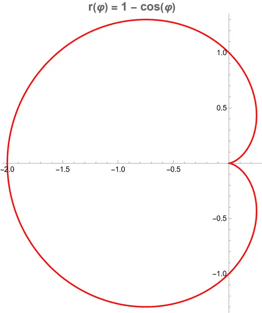

The answer in the book isn't a function of time. It's actually ##r=a(1-\cos\varphi)/\omega^2##, which described a cardioid. In the text, he defines normal acceleration as the component of acceleration perpendicular to the trajectory, so I think it's incorrect to identify it with ##a_\theta##.

Using Mathematica, I calculated the various components of the acceleration with the book's solution for ##r## and got
\begin{align*}
a_t &= \frac{a}{\omega^2}\left(\dot{\theta}^2\cos\frac \theta 2 + 2 \ddot{\theta}\sin\frac \theta 2\right) \\
a_n &= \frac{a}{\omega^2}\left(3\dot{\theta}^2 \sin\frac \theta 2\right) \\
a_r &= \frac{a}{\omega^2}\left[\dot{\theta}^2(2\cos \theta-1) + \ddot{\theta}\sin \theta\right] \\
a_\theta &= \frac{a}{\omega^2}\left[2\dot{\theta}^2 \sin \theta+ \ddot{\theta}(1-\cos\theta) \right]
\end{align*} where ##a_t## and ##a_n## are the components respectively tangential and normal to the trajectory and ##a_r## and ##a_\theta## are the components in the ##\hat r## and ##\hat \theta## directions.
The speed is ##v = 2\left(\tfrac{a}{\omega^2}\sin\tfrac\theta 2\right)\dot{\theta}.## If ##a_n = 2v\omega##, it follows that ##\dot{\theta} = \tfrac 43\omega > 0##. But then ##a_r## isn't constant.
Using Mathematica, I have also confirmed @vela 's result that the problem statement and the purported solution are incompatible. The plot of ##r\left(\varphi\right)=a\left(1-\text{cos}\varphi\right)/\omega^2## for ##a=\omega=1## shows that ##r## is clearly bounded:
But the condition on the radial acceleration is ##\ddot{r}-r\dot{\varphi}^2=a\Rightarrow\ddot{r}=a+r\dot{\varphi}^{2}## where ##a## is a positive constant. Integrating this twice w.r.t ##t## gives ##r\left(t\right)=\frac{1}{2}at^{2}+v_{0}t+r_{0}+\intop^{t}dt_{2}\intop^{t_{2}}dt_{1}r\left(t_{1}\right)\dot{\varphi}^{2}\left(t_{1}\right)##. Note that ##r\left(t\right)## grows at least as fast as ##t^2## when ##t\rightarrow\infty##, and possibly faster depending upon the behavior of the non-negative integrand ##r\left(t_{1}\right)\dot{\varphi}^{2}\left(t_{1}\right)##. Thus, ##r\left(t\right)## grows without bound for large ##t##, which shows that the problem statement is inconsistent with the stated solution.
