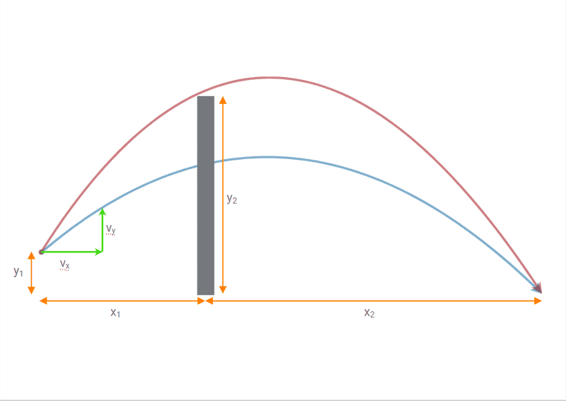

I am trying to solve for Vy with given Vx. I know how to do this for the BLUE trajectory line, but I do not know how to solve this if there is an obstruction in the way (like the gray wall).
My givens are:
X1
X2
Y1
Y2
Vx
Gravity
Do I need to solve for the blue trajectory then adjust that for the red trajectory? If so, wouldn't I be adjusting both Vx and Vy in that case? How do I do that?
It's possible this is very simple and I'm just not seeing it lol Also, I'm not concerned about the angle of projection here, I am literally trying to solve for the X and Y components of the initial Velocity. So unless it's absolutely necessary, let's try to keep Trigonometry out of this. (Me and Trig aren't friends)
ETA: I am also not concerned about time (t).
ETA: Do not assume Y2 is the max height of the trajectory, It's only the height of the wall. So X1 could be really small while X2 is really large - placing the wall really close to the projectile's initial position.

Did my image not post? It should make it clear.
How do I solve for Vy so that the projectile clears the X1/Y2 point and still hits it's target?

Can you write expressions for the vertical and horizontal positions as functions of time? When the projectile reaches x1, what must be its vertical position? That should give you all you need to solve for Vy.
Yes, I am calculating the blue trajectory based on functions of time and I believe this is the correct route to take, however, solving for Vy for X1 only does not consider the required X2 value. In other words, solving for Vy with required X1 and delta Y, the projectile would clear the wall but "landing where it lands". The projectile still needs to hit it's target, the given X2 still needs to play it's role. This is why I asked if the Vx would have to be adjusted. So how would I factor that in? I don't think I could simply solve for a new Vx based on the new calculated Vy.
This is what is not true in my scenario. The projectile's height shouldn't be EQUAL to y2 at x1, the projectile's height just has to be GREATER than y2 at x1 so that it clears the wall AND hits it's x2 requirement.
So how do I do that?
(I just realized there was a sub script button lol)
It should be obvious that the solutions that go over the bar are just a subset of all of the "blue" solutions which you have already solved. You just have to find the set of vx, vy such that it barely crosses the bar. And it should be obvious that any solution with a lower vx will also cross the bar. So just set up a system of equations.
vx * t = x1
vy * t - 1/2 g t^2 = y2
You already know vy as a function of vx.

I think the problem with this is that x1 and x2 are not constant. They are variables that will have different inputs Everytime I run the equation in my program.
Again, with given Vx, x1, x2, h1, and h2 - how do I solve for Vy so that the projectile clears the wall and lands at it's x2 position?

As it happens, I was just working out a similar problem to discuss in class- in my case, it was kicking a field goal; the ball has to clear the crossbar.
My first step was to combine the projectile motion equations for x(t) and y(t) into a single expression y(x). You should be able to do that, and it's easier if you do that in terms of the speed v and launch angle θ rather than the velocity components Vx and Vy.
Now you have three specified points on the trajectory: the start point (0,y1), (x1, y2), and (x1+x2, 0). That is enough information to solve for v and θ, and since you know Vx, you can get Vy.. Unfortunately, y(x) is a transcendental equation in θ, so you'll need to solve the equation numerically (I used Mathematica).
Edit: because you have specified 3 points, you have an overdetermined system- there may not be a v and θ that generates your trajectory.

I have no desire to specify 3 points though.
Point A - (0,y1) specified
Point B - (x1, >y2) y component is unknown
Point C - (x2,0) specified
The y component of Point B is an unknown variable and I don't care what it is along as it's greater than y2
So how do I go about this? Any suggestions?

Okay, so if we start over ignoring the blue line, what do we have? Looking at your figure we are given ##x_1, x_2, y_1,## and ##y_2##. We know nothing about ##v_x## or ##v_y## as they are defined using the blue line, but if we instead assume they are the x- and y-components of the initial velocity of a projectile that follows the red line, it appears you want to be able to solve for ##v_y## given ##v_x##. I don't understand why you can't do that the same way you did it for the blue line. That is why I asked you to show us how you're doing it for the blue line. Because I would then just do it the same way for the red line.
The red line is a parabola that passes through the points ##(0, y_1), (x_1, y_2), (x_1+x_2, 0)##. Aren't three points enough to define any parabola? In other words, there is only one parabola that passes through any three points.
I am solving the blue line based on the kinematic equations for time (time in the x direction, time in the y direction). When doing that, I have a given Vx, distance, and height - so solving for Vy is pretty simple. But when I introduce the wall (which can be anywhere between point A and B), it gets more complicated (to me anyways). My experience with this is extremely limited. I'm a software developer lol we don't need to know this stuff.
So if I went the 3-point parabola way, could you give me some info on that? Seems I'd have to form the equation and get a tangent line at my point A? Then derive the x and y components from that?

So I was able to get my "a" and "b" coefficients to form a parabolic equation and I verified that they are correct values for my given points. From here, I know how to get the slope by taking the first derivative, but what do I do after that?
equation:
y = ax2 + bx + c
y' = 2ax + b ← what does this actually give me and how do I get Vx and Vy out of it?

So I have figured all of this out. I had to change my approach a bit. In this scenario, ##V_x## and ##V_y## are both unknowns, so is angle ∅. With a given ##V_x##, you can either ensure that you clear the wall OR ensure that you hit your mark, but you can't do both. The parabola with 3 points solved this beautifully. Here was my approach.
At the point of launch of the projectile, I grab my 3 points:
##(x_1, y_1), (x_2, y_2), (x_3, y_3)##
For the given quadratic equation: ##y = ax^2 + bx + c##
I calculated the coefficients "a" and "b" using these two very ugly formulas:
##a = \frac{x_3(y_2-y_1) + x_2(y_1-y_3) + x_1(y_3-y_2)}{(x_1-x_2)(x_1-x_3)(x_2-x_3)}##
##b =\frac{x_1^2(y_2-y_3) + x_3^2(y_1-y_2) + x_2^2(y_3-y_1)}{(x_1-x_2)(x_1-x_3)(x_2-x_3)}##
Now I have my parabolic equation. From this, I find the tangent line at point ##(x_1,y_1)## by taking the derivative of my equation, finding the slope, pluggin that back, etc. From here, I can calculate an angle ∅ of the initial trajectory.
To get the required ##V_x## and ##V_y##, I find the max y value of my equation by evaluating the derivative where slope = 0. This gives me the max height of my trajectory.
Now I can use the following kinematic equation to find Vi, which I can further break down into it's ##V_x## and ##V_y## components given my angle ∅.
##maxHeight = \frac{V_i^2sin^2∅}{|2g|}##
All of this works beautifully and no matter what my ##x_1## and ##x_2## values are, the projectile always clears the wall AND hits it's mark.
Thanks to everyone who gave valuable insight. And special thanks to Mister T.

I would also like to add more insight to this. The solution we've come to only works if your parabola faces down. There are cases where ##x_1## is really small (relative) and ##y_1 > y_2## resulting in a parabola facing up.. In that case, you must approach the problem as if you were solving for the blue line.
In my situation, I am programming all of this. So once I calculate my ##A## coefficient for the parabola, I check to see if it is positive or negative. Positive (parabola faces up), negative (parabola faces down).
That can't be right. The parabola always opens down, in the direction of ##\vec{g}##.

I'm talking about deriving the equation of a parabola based on 3 points alone. This is before you introduce kinematics.
Example: look at the image in my OP - if ##x_1=5m##, ##y_1=10m##, ##x_2=30m##, and ##y_2=5m##, you can see that the parabola faces up.
The only purpose of the parabola is to give you a launch angle to be used to clear the wall. Then you introduce kinematics to solve for ##V_i## with the given displacement and launch angle.
If the parabola faces up, then you essentially have no obstruction to be concerned with, so it just becomes a basic kinematic problem. (Though this does require more knowns - i.e. max height, angle, ##V_i##, ##V_x##, ##V_y##, or ##t##)
One of your problems is that you have Vx and X2 as givens, and they might conflict. If the landing spot X2 is most important, then Vx will depend on the trajectory. A shallow trajectory (without the barrier) would have a high Vx, while a steep trajectory (well over the barrier) would have a very low Vx. So you need to decide what is your constraint, Vx or X2? You can't constrain both. If X1, X2, Y1, and Y2 are all fixed, and your projectile is required to graze the top of the barrier, then you can't start with Vx, you must solve for Vx and Vy together. If you don't care about the value of X2, then you can solve it for a fixed Vx.
I agree. My x and y values are fixed. I started going down the wrong path with Vx being a given. All of these variables can't be givens if you want to clear the wall. You must solve for Vx and Vy (or Vi and angle).
