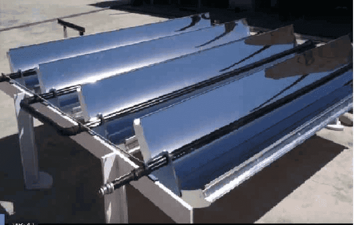

jrmichler said:
When heating a container of water, it does not matter if the heat is spread out over the container or concentrated in a small area, because the water circulates and distributes the heat.
Correct. But if the heat is collected over an area bigger than the area of the container, focusing does help.
Below are parabolic solar troughs.

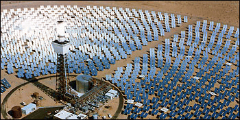

Then there's this monstrosity in California.
