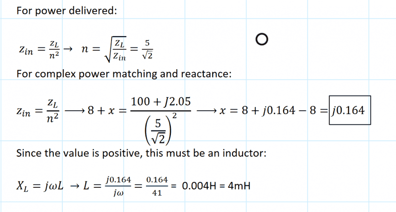

I
I must be missing something conceptually. How did you get this to a capacitor. This is what I tried
  • #34
Shenanigan_engineer said:
IView attachment 96947
Your first formula describes the impedance that the transformer presents to the rest of the primary circuit. Calculate that impedance without including the rest of the primary circuit.
Once you've done that you can consider the maximum power theorem for the new equivalent circuit in conjunction with the source voltage, its resistance, and whatever series device you choose to insert. Note that the equivalent impedance that the load presents to the primary is inductive. You choose a capacitor to add in series so that the maximum power transfer can be attained.

That helps a lot, after applying that to the problem it was a lot clearer. Thanks a ton.
