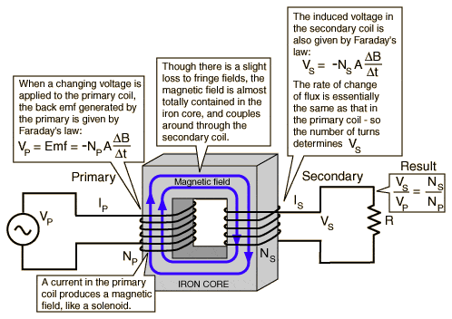

This question about the variation of the aforementioned quantities in a transformer.
Now according to me and my knowledge of electricity this is how I feel it should play out :
If the input current were a sine curve that varies with time then :
Input voltage = cosine curve i.e. it is ahead of input current by 90 degrees.
Magnetic Flux = sine curve with same period as input voltage but LARGER amplitude.
Output voltage = out of phase with input voltage by 180 degrees.
Output current = this is where I'm faltering and I'm having issues...
Could someone please confirm what I've said is correct and help me with the bit in bold ?
Could someone also confirm if voltage = rate of change of current with time ?

Anyway.. In academic approach an "ideal transformer" means that:
- we neglect the resistance of the windings -> the transformer has efficiency equal to 1 (Pin = Pout),
- we assume that the schematic of transformer contains only two coils (primary and secondary),
- current and voltage on both sides are connected only by turn ratio of coils,
- all waveforms (current, voltage, flux) are assumed to be sinewave,
Flux can be calculated from Faraday's law of induction. In this case (only inductances in schematic of transformer) we have:
Uprimary - 0 deg
Flux and I primary - 90 deg
U secondary - 180 deg
I secondary and counter flux - 270 deg

Uprimary means voltage measured between both terminals of a coil.
Currents in both windings are 90 deg behind voltages (currents are lagging).
In an ideal transformer with no load:
There would not be any primary or secondary current.
Magnetic flux would lag the applied voltage by 90 degrees.
Magnetic flux and voltage are in different units, so you cannot say one is larger than the other.
Output voltage phase depends on how the transformer is connected. Some engineers might say that input voltage and output voltage are 180 degrees out of phase. I consider output voltage and input voltage in phase.

They are techinically out of phase by 180 degrees...but who cares? So what you are saying is more or less true. When you hook up your load to your secondary...the voltage and current are in phase...and the reference point of you voltage is what it is. Referring back to the primary phase of the voltage doesn't do you any good unless you are playing with math. In the field...this info won't help you.
To elemis...since you are at a high school level...keep things simple. The turns ratio...power in = power out...and the formula for computing the resistance from the secondary back to the primary should be all you need at this point. Until these things are mastered...don't move on quite yet.

http://www.allaboutcircuits.com/vol_2/chpt_9/4.html <--- this page cites the two voltages as in phase, unless you reverse your output coil. It states that the coil polarity for practical scenario's is ambigious... and also explains the polarity markings I made reference to.
http://www.allaboutcircuits.com/vol_2/chpt_9/1.html <--- i agree with gerbi as well, saying to the OP that the magnetic flux is not in phase with the primary voltage but in phase with the injected current, but yes it is of a larger magnitude.
any corrections welcomed.
gerbi said the conditions were a perfect transformer with no load.
In a perfect transformer with no load.
There is no primary current and no secondary current.
The secondary voltage in just the turns ratio times the primary voltage.
The magnetic flux lags the primary voltage by 90 degrees. (Since there is no primary current, it doesn't make sense to say that the flux leads or lags the current)
