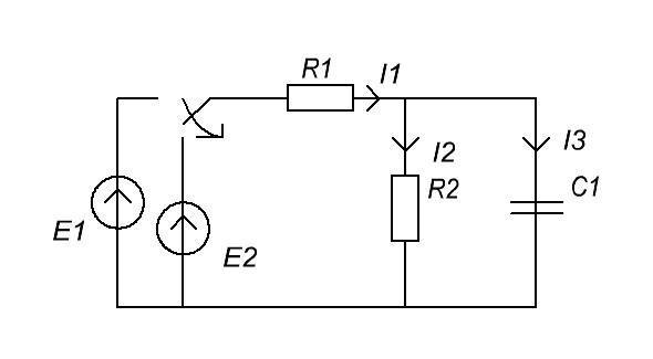

Find I1,I2,I3,Uc
I was trying to make this task but my result was not correct
Before commutation
I=E/(R1+R2)=0.1 A
U=0.1*R2=100 V
After commutation
I=0 A
In the moment
equatations
I1*R1+I1*R2-I3*R2=E
I3*R2-I1*R2=Uc
I3=C*dUc/dt
But when I had got result
Uc=-200e^(-100t)+100
It was not correct.
R1=1000 Ohms
R2=1000 Ohms
C=20*10^-6 F

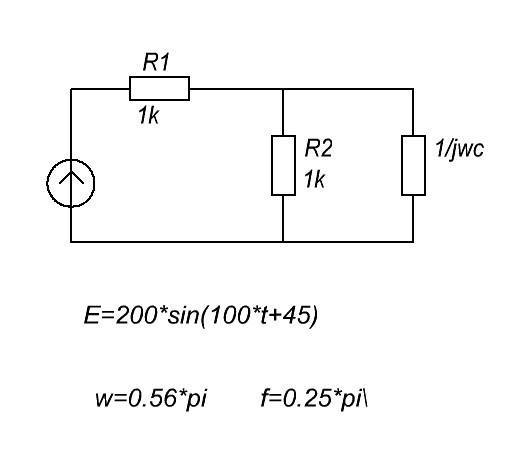

E1=200sin(100t+45*)
E2=100
Are there any elements in the circuit after commutation?
Currents have Clockwise direction
There won't many changes in case 2.
But is there impendance in case 3?

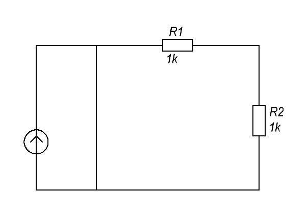

Could you label your diagram with the currents?
Which case are you evaluating? You seem to have an attempt at solution under "Relevant Equations" and additional problem information under "Attempt at a Solution".
pic.1?
I evaluate first case.all my results are equal to (-1)*results in the keys

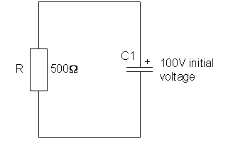

For the first case, when the switch closes the capacitor will discharge from 100V down to zero volts through the parallel combination of R1 and R2. The first thing to do is to evaluate the time constant (I see that you've calculated its inverse, 100s-1). Then just write the appropriate equations for exponential decay, Uc(t), Ic(t). The resistor currents can be found using the voltage equation.

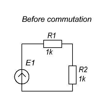

Before commutation?
Before the switch is moved, Only E1 is connected to the resistor/capacitor network.

There's the capacitor to be concerned with, too. It should figure in your equations if you're going to solve the problem that way. You'll end up with a differential equation.
The simple way is to just realize that there will be an exponential decay of the capacitor voltage, and just write down the well known formula for that.
For your case 1, after the switch is moved the equivalent circuit looks like this:

In case 3 is there resistance 1/jwC in the circuit?
builder_user said:
Ok. Math part can be solved by Mathcad.
Skip case 2.

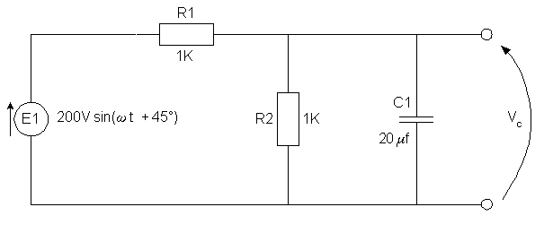

Yes, while the switch is in the E1 position (actually, it's called an impedance rather than a resistance). But when the switch moves to E2, that's a DC supply. In order to find out what the transient response is going to be when the switch is thrown, you'll need to know the actual instantaneous voltage on the capacitor at that instant. In other words, you'll need to know at what time, t, the switch is thrown.
You will have to write an equation for the voltage on the capacitor with respect to time when the circuit is being driven by a sinewave. Plug in the time t when the switch action occurs to find the value.
So I can't do like this
Req1=R2*1/(jwC)/(R2+1/(jwC))
Req2=R1+Req1
I=(Emcos(f)+j*Esin(f))/Req2?
Sure. (Assuming f = ωt). That applies before the switch is moved to the DC source. What will be the voltage on the capacitor at the instant the switch is moved?

Ah. Your f is the phase angle. Okay. Then you still need to plug in t to find the instantaneous voltage on the capacitor when the switch is thrown.
I think voltage will be the same as voltage on R2
My instant. voltage on C is = 72+69*jand w is the same as w in E(t) right?
When Xc=1/wC without j?
Yes, the voltage will be the same as the voltage on the resistor R2, since it is in parallel with the capacitor. But you must include the impedance of the capacitor when you find that voltage. Also, the voltage you find will be a phasor for the steady-state AC voltage on the capacitor -- not the instantaneous voltage at some particular time t.
I've just done a calculation and I find that the phase shift due to the resistor-capacitor network at the given driving frequency actually happens to "undo" the phase shift of the source voltage! So the result is a pure, unshifted sinewave (no phase angle) on the capacitor. Clever choice of component values!
