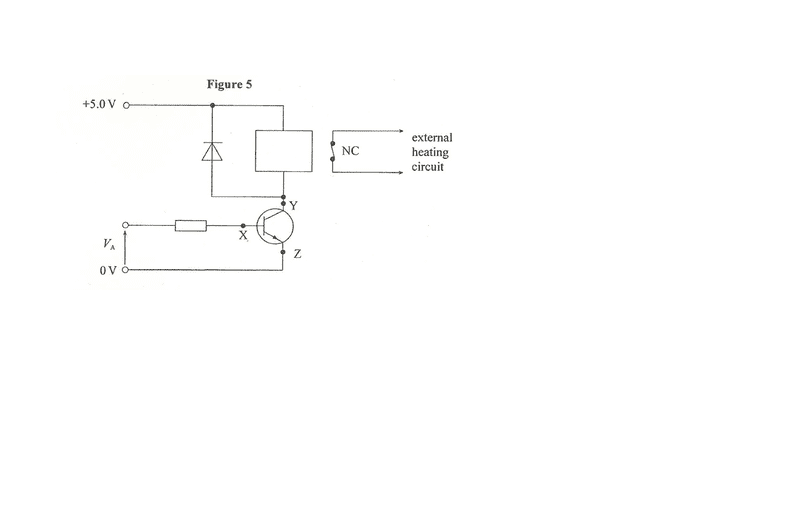

Thanks for your answer 256bits! I think that makes sense now. I have attached a diagram from my textbook of a relay circuit which uses an NPN transistor and would be very grateful if you could clarify a few things. So, with this transistor I assume it would be a BJT, is that right? When the base has a positive voltage it says that the current flows from +5V through the relay and then through the transistor from collector to the emitter. Inside the transistor would you therefore have to say that 'holes' are flowing from collector to base? Similarly if you were talking about electrons would you have to say that when a positive voltage is applied to the base, electrons flow from ground (0V) through the transistor (this time from emitter to collector) then through the relay to +5V. Is that correct?

Your circuit uses the symbol for an NPN BJT transistor, so there's no reason to think it is something different.
If you want to understand what the transistor does as part of the complete circuit, don't tie yourself in knots thinking about electrons and holes. Just think about conventional currents, that always flow from positive to negative voltage.
If you want to understand the physics of how the transistor actually works, then of course you do need to think about electrons and holes. But the best way to deal with complicated situations is break them down into simple pieces. The "physics" of how the transistor works is one thing. The "electrical engineering" of how to use it in a circuit is another thing. You don't often need to think about both things at once.

Thanks AlephZero. So what would be the correct way of interpreting the BJT NPN transistor in the diagram in terms of electrons/holes? If we stick with conventional flow like you said which means the collector is positive and the emitter is negative. Would you therefore have to talk about holes moving within the transistor from collector to emitter? Or does it now start to get too complicated.
