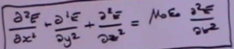

I've been following the derivations in the following video up until that point. I don't quite understand why does it imply that μ*ε=1/c^2. Thanks.
Check out the wave equation earlier on in the video (10:20) . ##v^2=\omega^2/k^2 ## and ##{1\over \mu_0\varepsilon_0}## takes that place, so ##v^2 = {1\over \mu_0\varepsilon_0}## .
