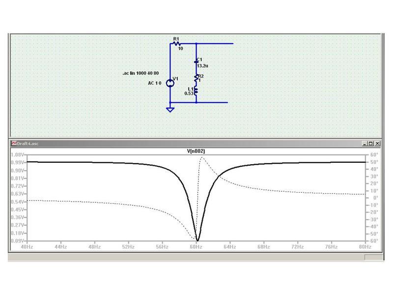

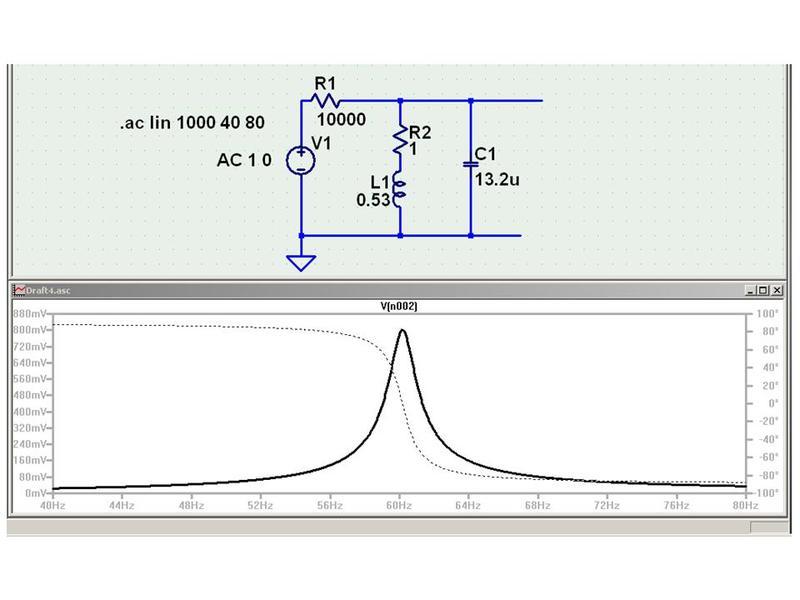

Here are two tank filters suggested above, one a series resonant and the other parallel. with the frequency swept from 40 Hz to 80 Hz. See attached thumbnails. In this case, L=0.53 Henrys, and C = 13.2 microFarads. The impedance is sqrt(L/C) = 200 ohms.

Great graphs, Bob S.
Was that done with Spice?
I guess 1 ohm resistance is a bit difficult for a 0.53 H inductance but if it could be held below 20 ohms, to get a Q of at least 10, you would still get reasonable selectivity.
The circuit modeling and frequency sweeps were done with LTSpice IV, free from Linear Technology Corp.
