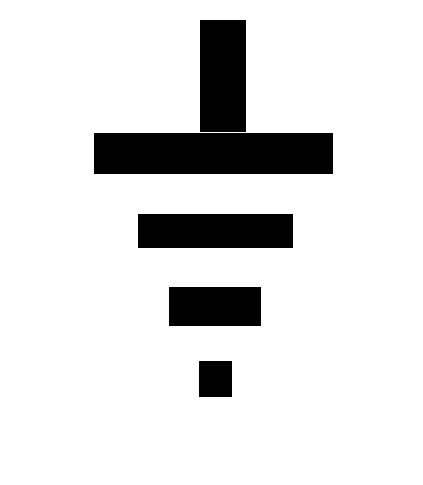

Did you try earthing some point of the previous circuit? Like the negative terminal of the battery? I have a simulation program that insists on having some point in the circuit earthed.

second, is i haven't grounded the previous circuit, my software don't insist me. But i will try to ground it. Can you please give me the image that how to ground.

You should be able to place a ground symbol, and then add a wire to connect it.
An Earth symbol looks like this:
