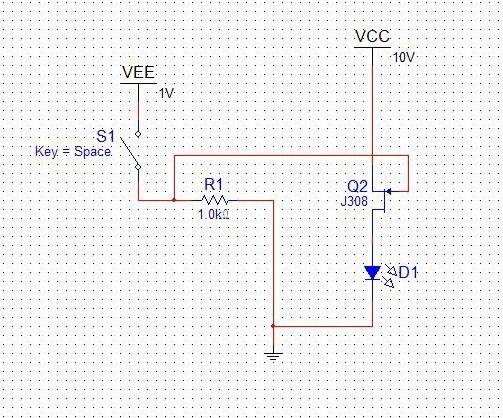

Here's what I am trying to do -
Turn ON a LED using a JFET. I have attached the ckt. I changed the JFET to J308.
Without the LED, the Idss is about 40mA which is close to what the datasheet says.
But when I add the LED between the source terminal and ground, it doesn't light up.
If I forward bias the gate with 1V, the LED lights up.
The LED needs only 20mA to light up.
I have attached the schematic.

LED voltage drop is the voltage drop across the LED (typically about 1.7 - 3.3 volts; this varies by the color of the LED)
http://en.wikipedia.org/wiki/LED_circuit"
In my ckt, LED drop is 2V.
