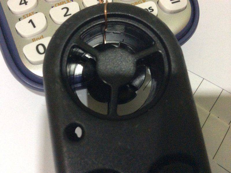

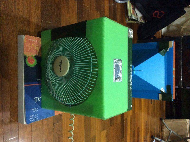

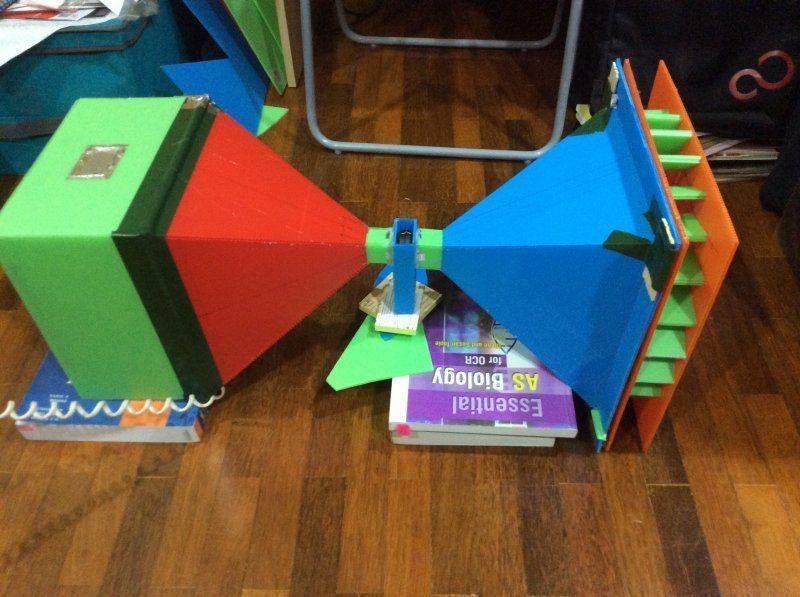

I guess you're right, I carried out an experiment with this wind tunnel I built:
, powered by a desk fan:
. The anemometer I got, is this model:
with a propeller typed-blade. And is located in the blue cuboid casing between the 2 pyramids.

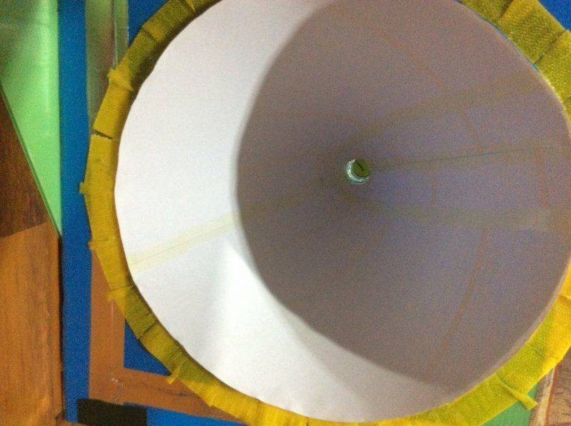

So it works by using the desk fan, located at the red pyramid, to suck in air through the blue pyramid, and the wind speed will be increased due to the Venturi effect, by 10 times, and pass through the anemometer, where the wind speed, or in this case, rate of propeller rotation, will be measured.

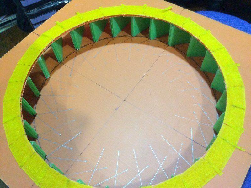

Thus to create a vortex/rotational/circular airflow, I made a "filter", by placing columns 45 degrees to the circular opening:
, to make this:
. When the air gets sucked in due to desk fan, in theory, the wind should be sucked in 45 degrees to the opening and thus creating rotational airflow(same clockwise motion as my anemometer's rotation to straight airflow).
I did 2 experiments, 1 without the "filter":
, and the other, with. Here are my results
After measuring the wind speed(km/h) every 30 seconds, for 5 times.
The average wind speed of the experiment WITHOUT the filter, was: 14.48 km/h
The average wind speed of the 2nd experiment WITH the clockwise filter, was: 13.2 km/h
A 8.8% wind speed/performance drop...

Steve, as far as I can tell Sir. You are One: placing restriction in the air flow with the 'filter'. Two: The way the vanes are placed, is cause for air flow direction change which causes turbulence. Turbulence 'eats' energy which will show as energy lost (velocity drop). Perhaps try placing vanes attached on the outer inside edge/mouth of your cone if you feel you must 'induce' a vortex. Better still, in that flow configuration, a vortex should form of it's own accord as is natural especially if you were to build your cones with a more shallow angle. Study the overall cone structure of say, a tornado. Very shallow around 10 or so degrees depending on your requirements. Always think smooth laminar.
