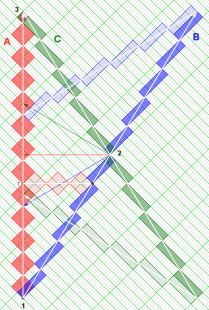

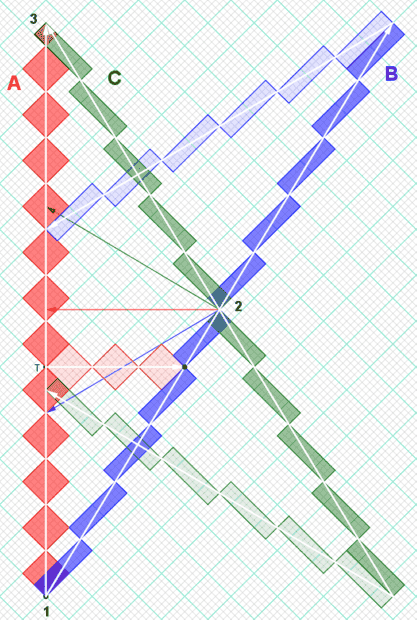

Spacetime diagrams are great for organizing one's thoughts
and giving interpretations to various symbols in formulae.
In the end, it can provide a summary of various calculations and interpretations
that one did [and many more that are suggested .. or could be suggested... by others]
to provide fuller storylines for what happened.
a spacetime diagram (...made fancy with tickmarks shown)
By drawing the grid of C's diamonds (instead of A's as above), you effectively do a Lorentz boost (and translation).

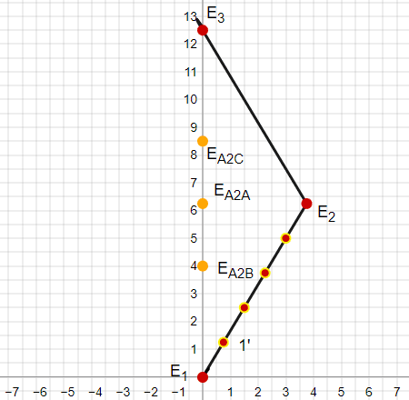

h1a8 said:
2. Since A is moving at v_A = 3/5c relative to C then t_C=5/4t_A. So, when t_C=10 then t_A=8.
Contradiction?
By calculating backwards from ##t_A = 12.5## at event ##E_3## you can see, that there is no contradiction.
Because object ##A## is moving and therefore time-dilated with reference to the inertial restframe of object ##C##, object ##A## needs ##\Delta t_A = 4## elapsed time to move from event ##E_{A2C}## to event ##E_3##. Event ##E_{A2C}## is the event on ##A##'s worldline, which happens simultaneously to event ##E_2##, with reference to the inertial restframe of object ##C##.
At event ##E_{A2C}##, ##A##'s watch showed ##t_A = 12.5 - \Delta t_A = 8.5##.
h1a8 said:
QUESTIONS:
1. What will A’s clock read at Event 2?
Event ##E_2## does not happen on object ##A##'s worldline.
  • ##A##'s clock reads ##4## simultaneously to event ##E_2##, with reference to the inertial restframe of object ##B##.
  • ##A##'s clock reads ##6.25## simultaneously to event ##E_2##, with reference to the inertial restframe of object ##A##.
  • ##A##'s clock reads ##8.5## simultaneously to event ##E_2##, with reference to the inertial restframe of object ##C##.

How did you get that A's clock read 8.5 simultaneously to event 2 with reference to C?
You can see the answer in my above posting #17.

robphy said:
You can also look at the diagram (cloaked by the spoiler tag) in #14.
I don't see the logic of how C's line points to 8.5 on A's line at event 2.
Wouldn't that be circular? Working backwards (assuming A's clock reads 12.5) to obtain results so that there is no contradiction.
Is there a forward process (without graphs and assuming A's clock reads 12.5 at event 3) that tells us A's clock reads 8.5 in C's frame at event 2?

h1a8 said:
Here’s my attempt
1. Since B is moving at v_B = 3/5c relative to A then t_A=5/4t_B. So, when t_B=5 then t_A=6.25.
You calculated correctly "forward", that A's clock reads ##6.25## at event ##E_{A2A}##, which is simultaneous to event ##E_2## with reference to A's frame.
Let me call A's frame ##S## and C's frame ##S'##.
With reference to A's frame I calculate now the ##\Delta t## between event ##E_2## and event ##E_{A2C}##, which is simultaneous to event ##E_2## with reference to C's frame (##\require{color} \color{red} \Delta t' = 0 \color{black}##).
The spatial distance ##\Delta x'## between event ##E_{A2C}## and all events on C's worldline (including ##E_2## and ##E_3##), with reference to C's frame, is
##\require{color} \Delta x' = 5 \cdot \frac{3}{5} = \color{blue}3\color{black}##.
("Travel distance", Object A needs 5 seconds coordinate-time to move from event ##E_{A2C}## to object C, with reference to C's rest frame.)​
I will use the Lorentz transformation (with unit system ##c:=1##).
##\require{color} \Delta t = \gamma (\Delta t' + \frac{v}{c^2} \Delta x') = \frac{5}{4} (\color{red}0\color{black} + \frac{3}{5} \cdot \color{blue}3\color{black}) = 2.25##.
Adding this result to your ##6.25## gives:
## 6.25 + 2.25 = 8.5##.
To appreciate the diagram, there are 2 things you need. The first is the ability to draw, or at least understand, space-time diagrams. To make this more specific, you need to know how to draw the space-time diagram of a light clock. We will give an example below, but first we will talk about the second thing you need to know, which is the Einstein clock synchronization convention. This convention formally defines what we mean by clocks being syncrhonized in a given frame. We will now use a space-time diagram to explain the Einstein convention.
First let us focus on the red square.
The red square, with events ABCD is a light clock.
AB represents a light signal going to the left emitted from A and going to B. BC represents the light beam AB continuing on, after it is reflected at B, now going to the right.
AD represents a light signal starting at A and going to D, and DC represents the previous light signal reflected and going back to the left.
On this diagram, AC (not drawn) is a timelike worldline, that represents a clock traveling from event A to event C. The line segment BD (not drawn) is a spacelike worldine, representing two different events, B and D, that occur at "the same time" in the frame in which AC represents the worldline of a clock at rest.
If we consider some event O in the middle of the spacelike worldine BD, we can say that events B, O, and D all occur at the same time. The reasoning for this is that events B and D are equally distant from the worldline AC, and that because light travels at a constant speed, the time it takes the light signal to go from A to B is the same amount of time that it takes for the light signal to go from A to C.
This is all simple enough, but where things may get harder to understand is that EFGH also represents a light clock. The logic is the same for the light clock ABCD, and we can conclude that in the frame in which EG is at rest (which is not the frame the diagram is drawn in, unlike the previous case) that events F and H must be simultaneous.
Given that one understands WHY events B and D are simultaneous in the frame in which AC is at rest, and that one understand WHY the events F and H are simultaneous in the frame in which EG is at rest should explain Rob's diagram.
So, the two things one needs to understand are how to draw and interpret space-time diagrams, and the Einstein definition of what simujltaneity means in some specific frame. A related point one needs to understand is that in special relativity, simultaneity is FRAME DEPENDENT. Two events that are simultaneous in one frame are NOT simultaneous in another frame. In our diagram, events B and D are simultaneous ONLY in the frame in which AC is at rest, they are not simultaneous in the frame in which EG is at rest. Similarly, events F and H are simultaneous ONLY in the frame in which EG is at rest, they are NOT simultaneous in a frame in which AC is at rest.
There are some more advanced points to be made, specifically the significance of "equal areas" of the light clocks ABCD and EFGH being the same, but that's probably left for some future date. The important thing to grasp is the fact that in special relativity, simultaneity is FRAME DEPENDENT, and to understand the operational definition of simultaneity using light clocks.
