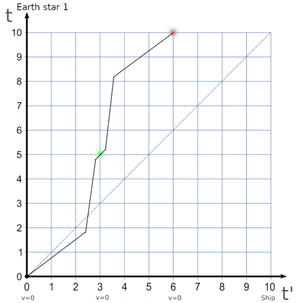

LikenTs said:
Thanks for the responses and sorry for the delay. I have been studying accelerated frames in SR, to understand the key factor that indicated @Sagittarius A-Star, the importance of the sense of accelerations and dependence on distance.
So, this would be roughly the earth display clock on the ship, with non-instantaneous accelerations. The accelerations that matter are the far ones.
Graph 1
I think your graph 1 in posting #16 is OK. I assume, that ##t'## means the coordinate-time of the restframe of the ship, which is at the location of the ship equal to the proper time of the ship.
This non-inertial restframe can be approximated by a sequence of many different momentarily co-moving inertial reference-frames.
