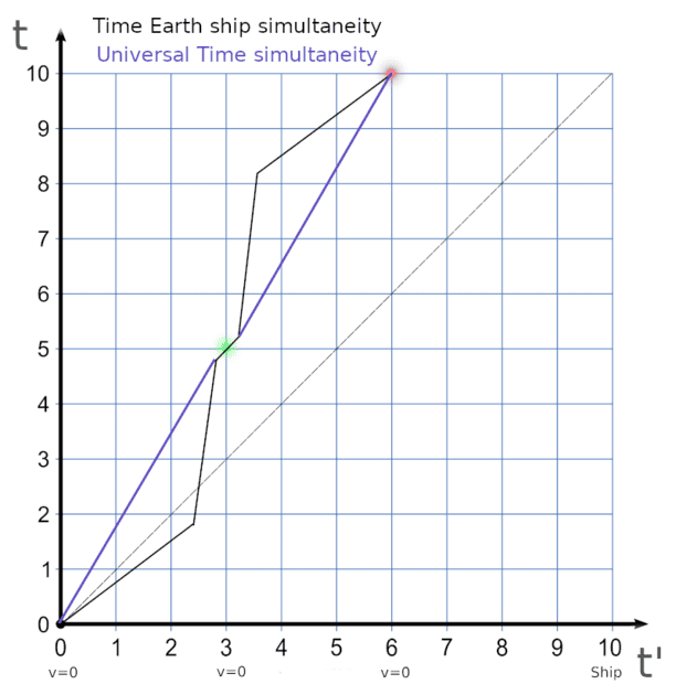

Proper acceleration can be directly measured, but its effect on differential aging cannot; to explain that you have to use the object's worldline and spacetime geometry.A.T. said:these are different levels: Proper acceleration is something physical, that you can measure
The only real "direct measure" that can be used to predict differential aging is the Doppler shift of light signals.
Even this is not true. The length of time that the traveling twin goes out before turning around also plays a role. So does the traveling twin's velocity relative to the stay at home twin during the outbound and inbound inertial legs.A.T. said:Within SR (where the twin paradox usually first comes up) the acceleration profiles fully determine the proper time intervals between two events
